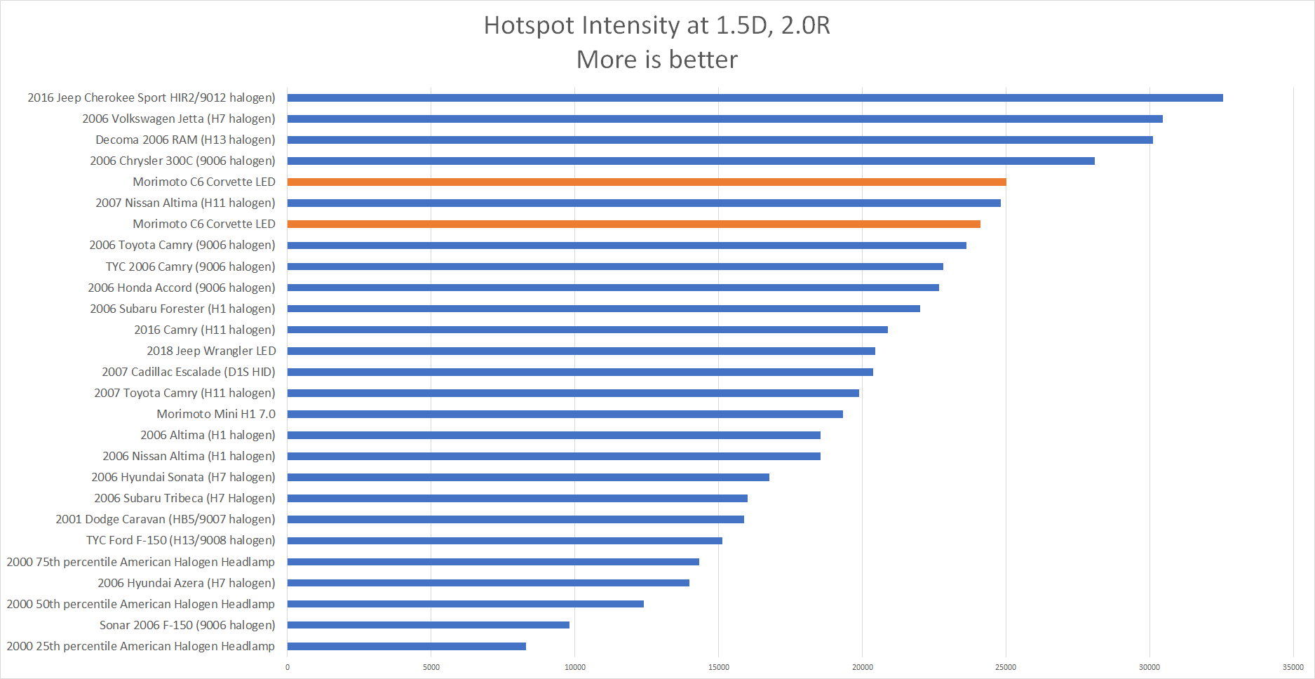

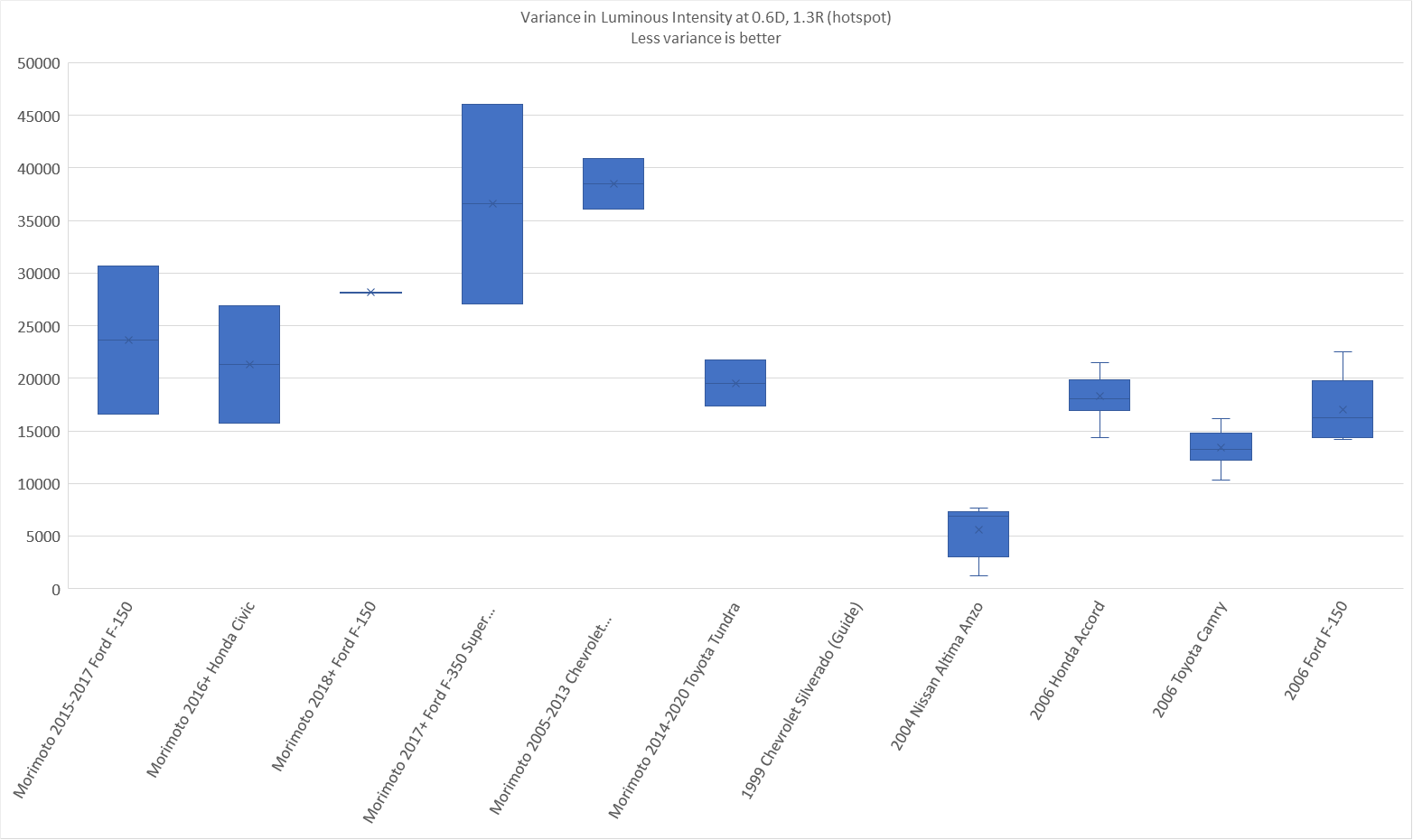

I suggest returning them when you have time. The LED emitters they are using are weak, and the optical design is middling. And as you found out, the quality control is lacking. I've analyzed several pairs of their headlamps and found tremendous variances between samples--much bigger variances that I'd expect from a pair of OEM headlamps.
The size of the bars in the below chart represent the amount of variance in luminous intensity for various headlamps. Morimoto's are all on the left half of the chart. OEM lamps are on the right. Note the much smaller variances (smaller bars) present across various OEM lamps.

That's some good data. Do you do this analysis as part of your job or just for fun? As someone who likes to play with Excel spreadsheets I can see where it would be for fun but how do you get so many samples to test? Just curious

Not sure how you get your info but I had the C6 Morimoto lights and they were almost twice as bright as OEM. I blinded everyone in front of me.

After reviewing the charts in more detail, the Morimoto have more variability overall, but they are still brighter overall about 80-90% of the time. Plus, there is no evaluation for c7 stock lights or the Morimotos for the c7. Not sure what you're trying to prove as this data doesn't apply to the c7 or the Morimoto lights for the c7.
