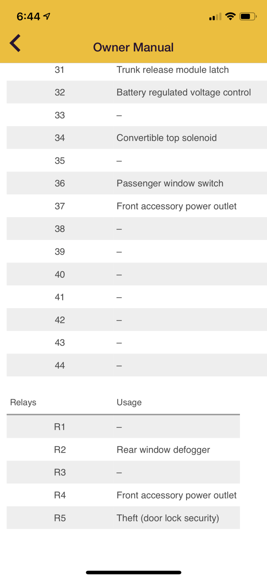

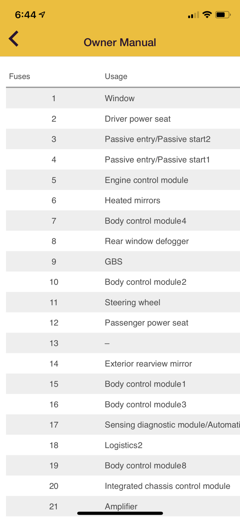

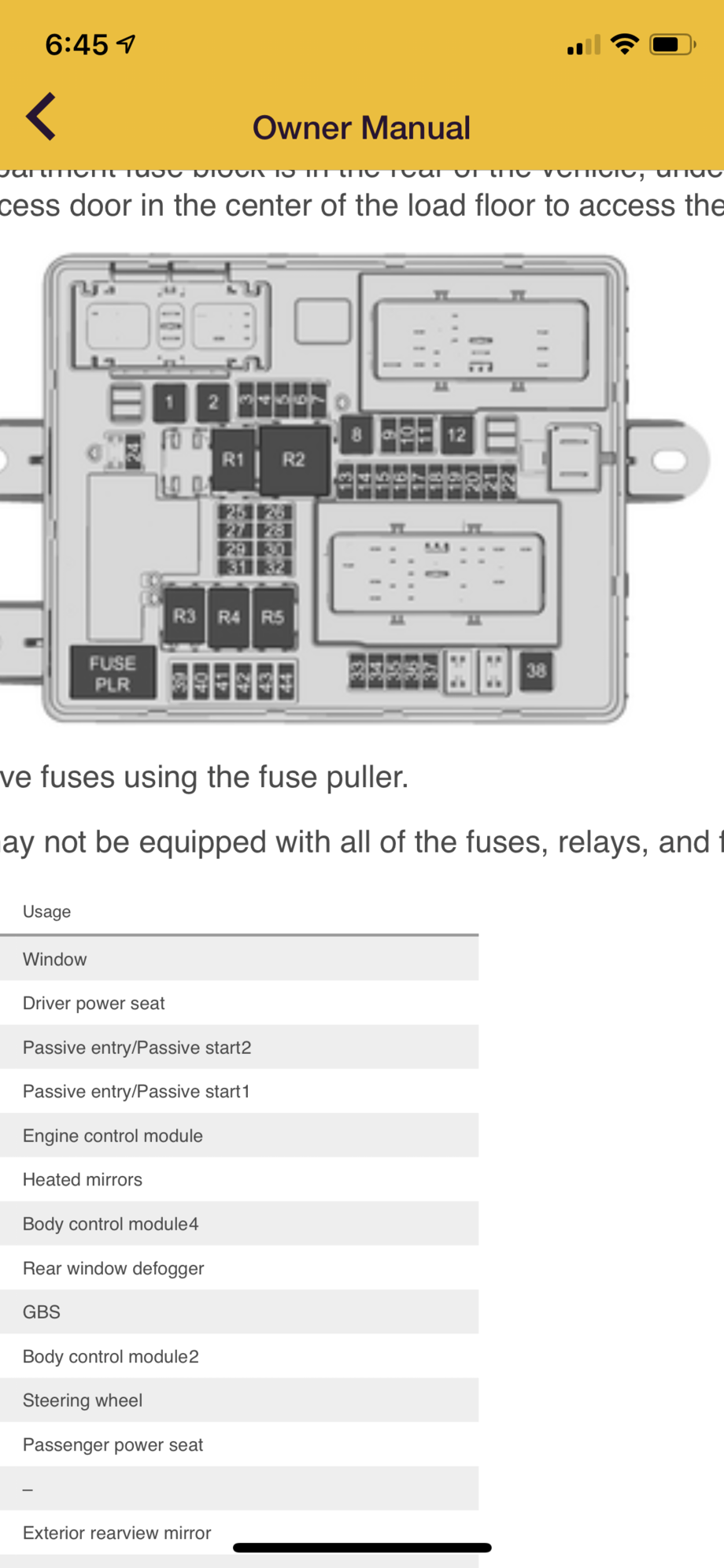

I would look a 2,3 and R5 all in the trunk for starters.

Thanks, checked the fuses in the rear compartment - all were OK.
Also, the relay clicking in the front fuse compartment was the head light relay, #61.
I do hear a relay clicking on the passenger side inside wall, I haven't taken the carpet out yet to verify, I assume this is where the BCM is located.
Verified that all the BCM related fuses (front and back) were OK
I did notice that while the door lock lights work, and the interior on/off lighting, there is no sound of the locking solenoid working.
