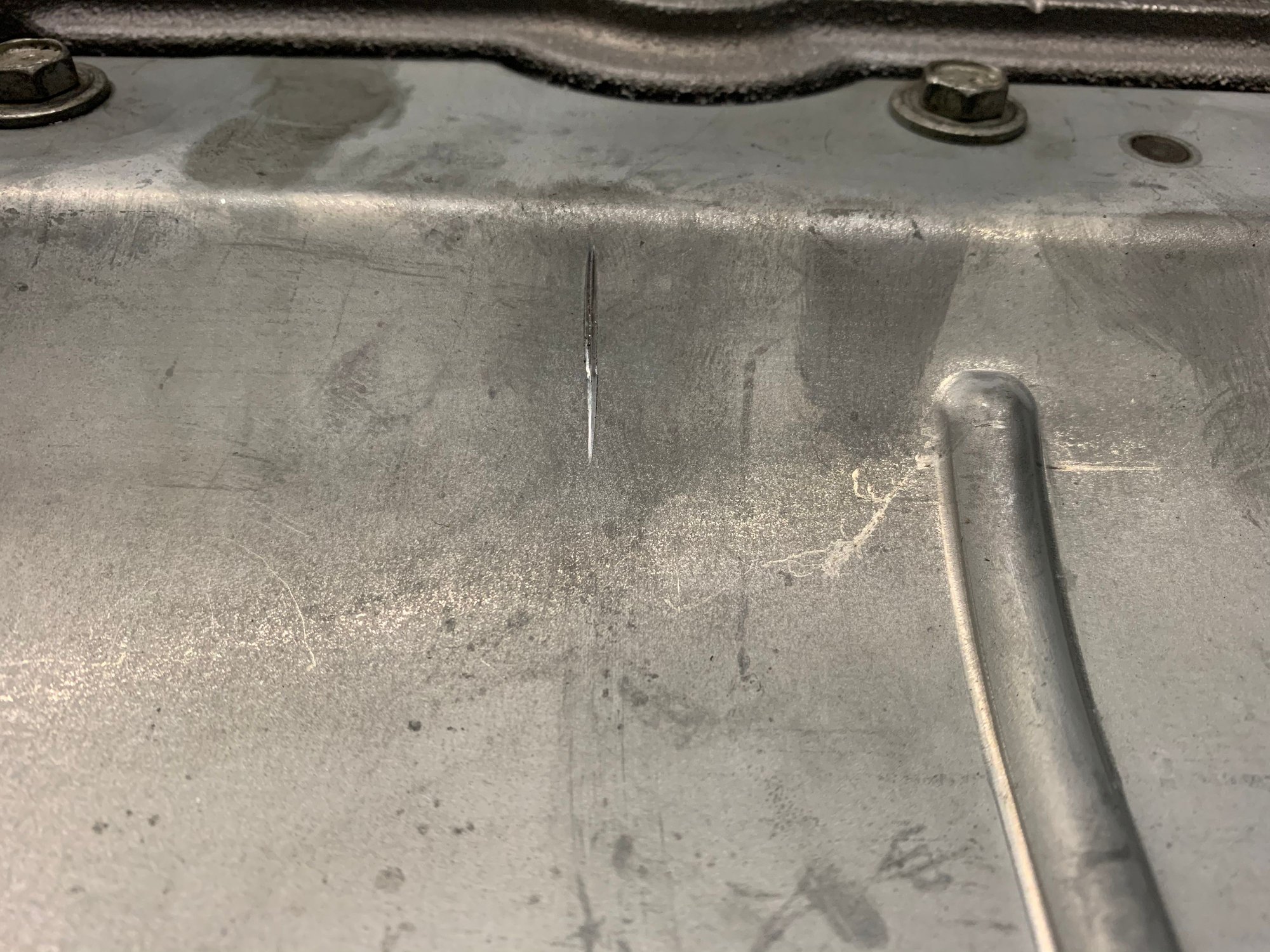

does anyone know what I can do about the rods, rod bolts, or crank hitting the windage tray and pickup tube. I have a wetsump 416 stroker from Thompson. Started to assemble the motor and came across this issue. The windage tray attaches to the oil pan, not the block, so I can’t use shims.
This is one of the places where it hits.
This is where it hits at
any help is much appreciated!!!

Did you solve this issue?? I dm you on instagram also, currently have this issue on my gen v lt1 6th gen, don’t know what to do.

barely any contact it looks like? I'd just bend it. I've done far worse on higher stressed engines.
