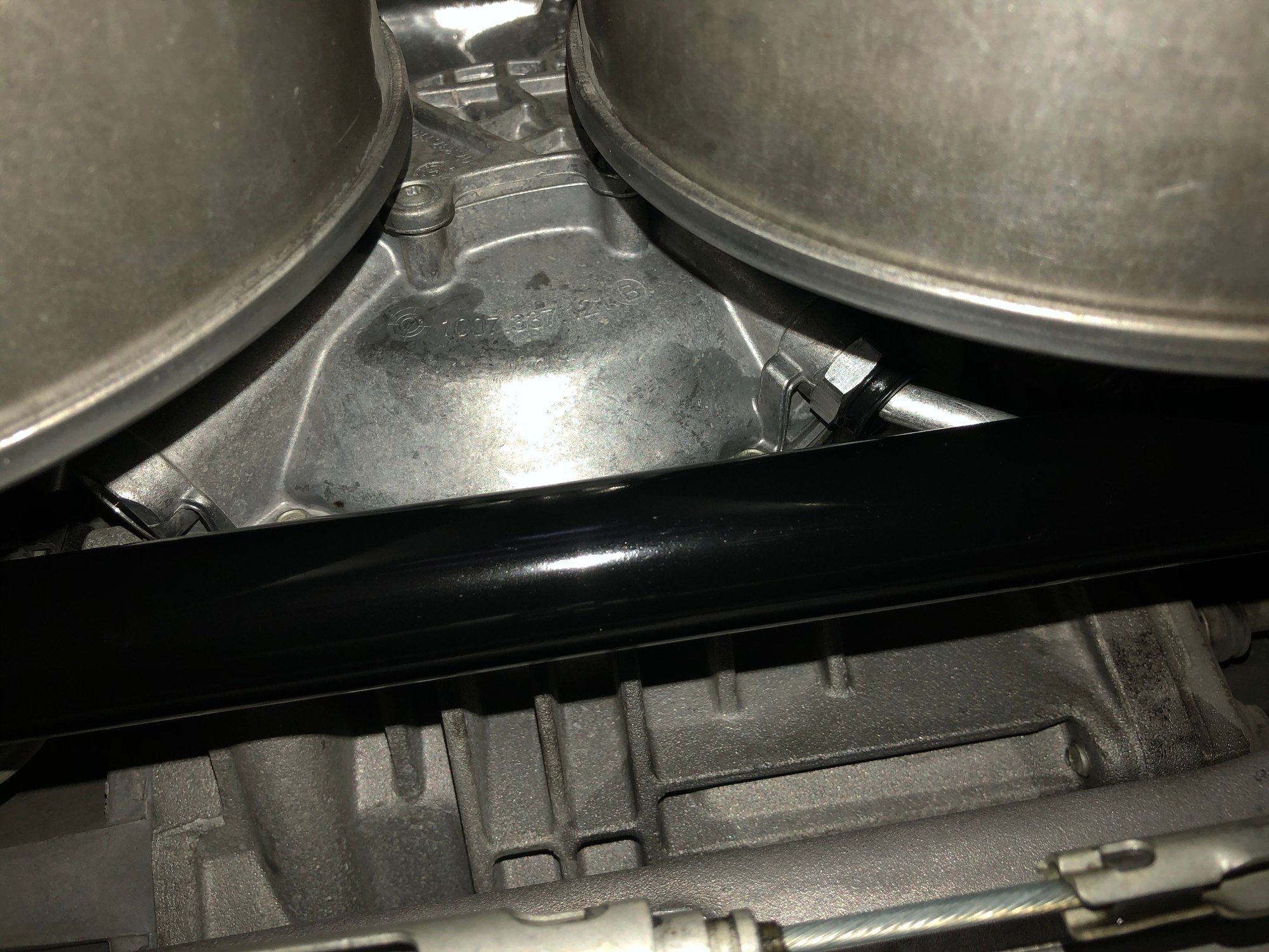

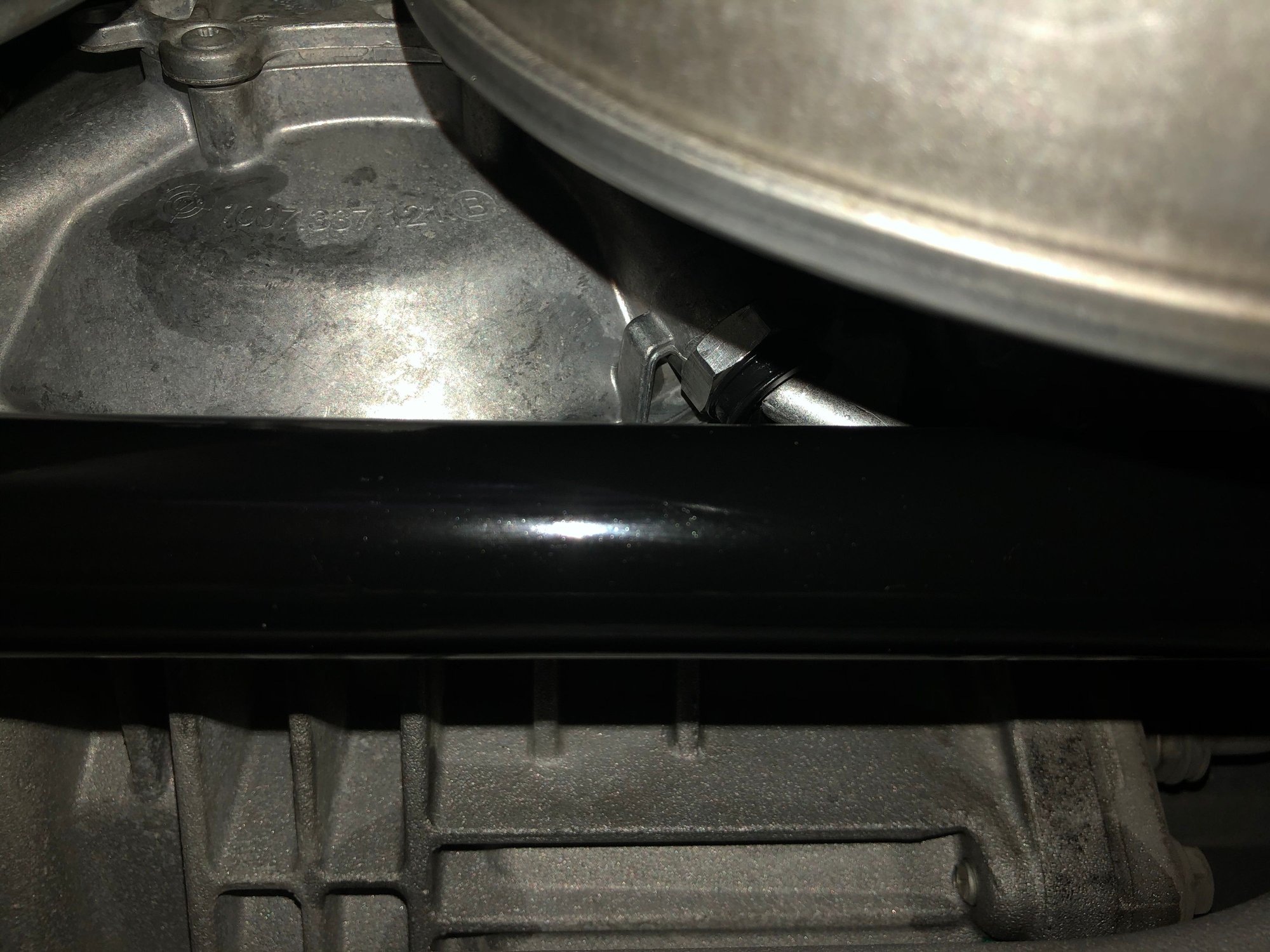

Hello. So I changed my differential fluid yesterday, but I noticed two things: First, that there were nowhere near 3 quarts in the differential, and second, that there was a slow leak coming from an area near the fill port of the differential. I see a black plastic o-ring that moves freely (cannot be tightened) next to a nut that attaches a line of some sort to the differential. I am not mechanically inclined enough to know what this o-ring's function is, nor can I tell if the leak is serious.
From what I can see it looks like if I just threw some JB Weld on the o-ring it would stop the leak, but I'm not sure if the leak is indicative of any serious problems. I also can't tell if it would be an important area to access in the future. For all I know it could be some kind of overflow line and maybe I overfilled the differential? I just don't understand what it is. Can anyone tell what the o-ring does, and perhaps what the line does? Thanks in advance, I'm pretty concerned.
It's basically right above the black bar to the right of the photographs in both pictures. You can see the nut and the o-ring basically is adjacent to the nut but spins freely.

Those pipes where the "Oring" and nut are, those are the pipes to the diff oil cooler. If the leak is just seepage, and no drips, I wouldn't worry about it.
I don't know if it is normal for the black Oring (probably really a bushing) to be loose.
Well, it's not really seepage either, it does drip enough onto the black shaft to cover it with oil. But that said, I didn't see this happening before I changed the fluid, and I do know it was low from the factory, so that led me to believe maybe I overfilled it, although it was level and dripping out the fill hole?
I was reading around and it appears that there is a vent line for the differential as well, which leaks oil if the differential is overfilled...this isn't where the vent line would be though, right? Everything I read about the location of the vent line indicates it's above the differential, not towards the bottom.
Assuming it is what you think it is, it wouldn't hurt to spray some sealant on it?

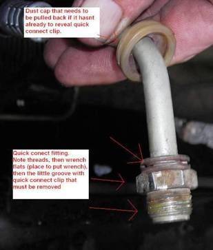

That black plastic ring is retainer to keep the clip holding the cooler line in place. It doesn't tighten, just clips over the fitting. If you slide it off the fitting you'll see what I mean.
