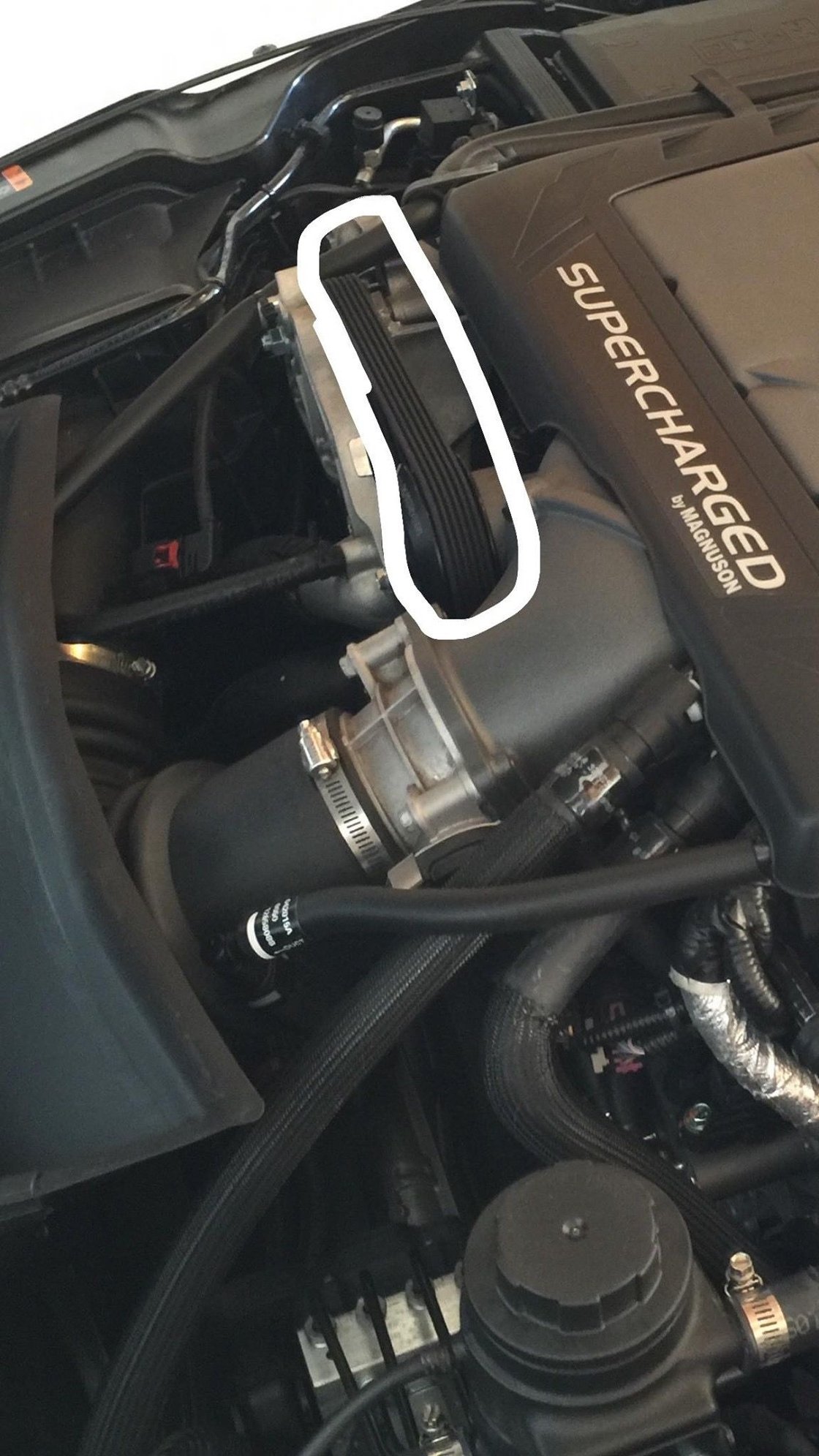

Hello Guys!
i recently bought a 2015 corvette z51 pacific edition with a magnuson heartbeat tvs2300 !
unfortunately the serpentine belt wasn’t that good!
Since i’m from el paso texas and the car is in Albuquerque it’s kinda hard for me solve the problem’
the previous owner is trying to find that serpentine belt but we got no luck!
i’m posting a picture so u guys can see which is the one i need and if u guys can provide me a part number or a link to order it i would appreciate it
serpentine belt is supposed to be a dual sided with 6 ribs each side , also, they added a belt tensioner probably that’s why it’s dual sided!
also how many belts should the car have only 1 or 2, i really need help this is freaking me out!

I would email or call Magnuson. They can sell you the belt or maybe provide the belt part #
In my experience most supercharged cars have 2 belts but i am not 100% sure on the stingray 2300 setup. From the pic it looks like the double sided belt is running the blower so you may only have 1. You're probably going to need to contact magnuson

I found this using the googalizer... but I would call Magnusson just to be sure as suggested. Looks like it's a dedicated S/c belt only and factory belt remains like the edelbrock does. GL.
Chevrolet Corvette 2014-2017 C7 LT1 HeartBeat. Please take a few moments to review ... warranties and CARB certification. Drive belt = Dayco #21-2798 (Custom 2435 mm length) Order through Magnuson Products ...

Correct, mentioned in the 2nd page
https://b.cdnbrm.com/images/info/Mag...f?icid=MagnuSC

FWIW buy a spare belt or you'll end up in the same position next time it breaks.

Yeah, hit-up the vendor first if their "standard" install was done. Also, I've had great experience taking belts into NAPA and having them measure and look. Many such come in about 1/4-1/2 inch increments allowing adequate fitment under most situations, even custom where the vendor (such as Magnuson) may not be able to do so. All the best!
