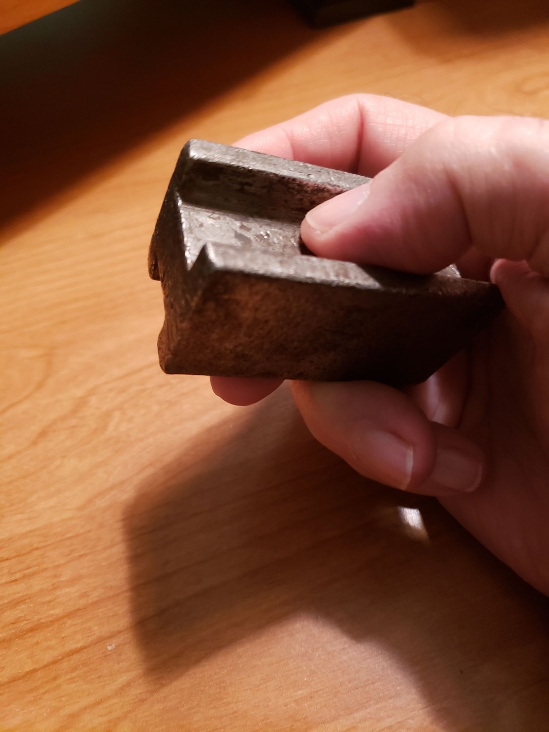

Here is the block I use instead of a hammer to tap the pins in/out.
Its heavy enough to generate enough force in the confined space to drive the pins home.
