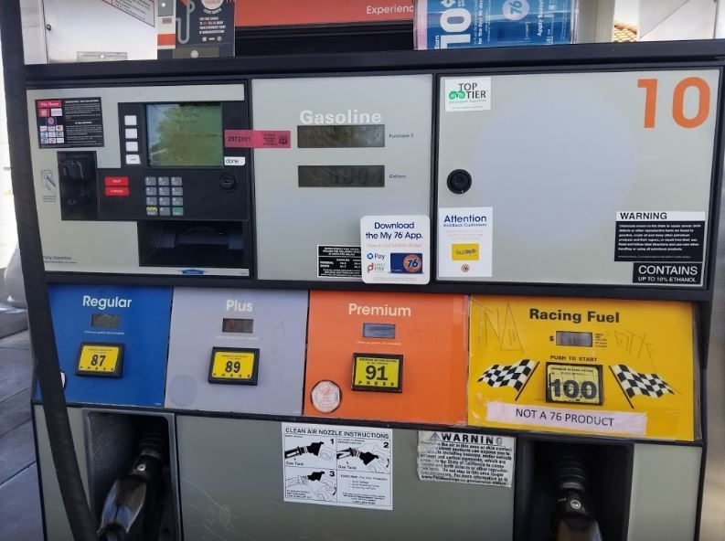

76, 2043 W Commonwealth Ave, Fullerton, CA
Give the race gas a try. I believe that it is actually Sunoco SS100.

Posts: 5,348
Likes: 3,318
make certain the race fuel doe not contain lead.

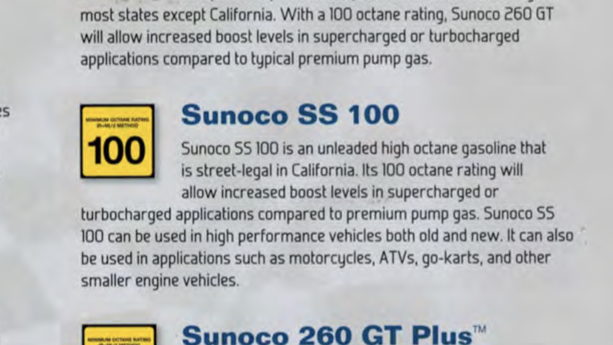

Here is what I found on sunco 100.

Thanks to all for your input on this subject. Thanks for the tip on the location for the 100 octane laserdude, love the name by the way. Wish I knew this before hand, but hey live and learn.
