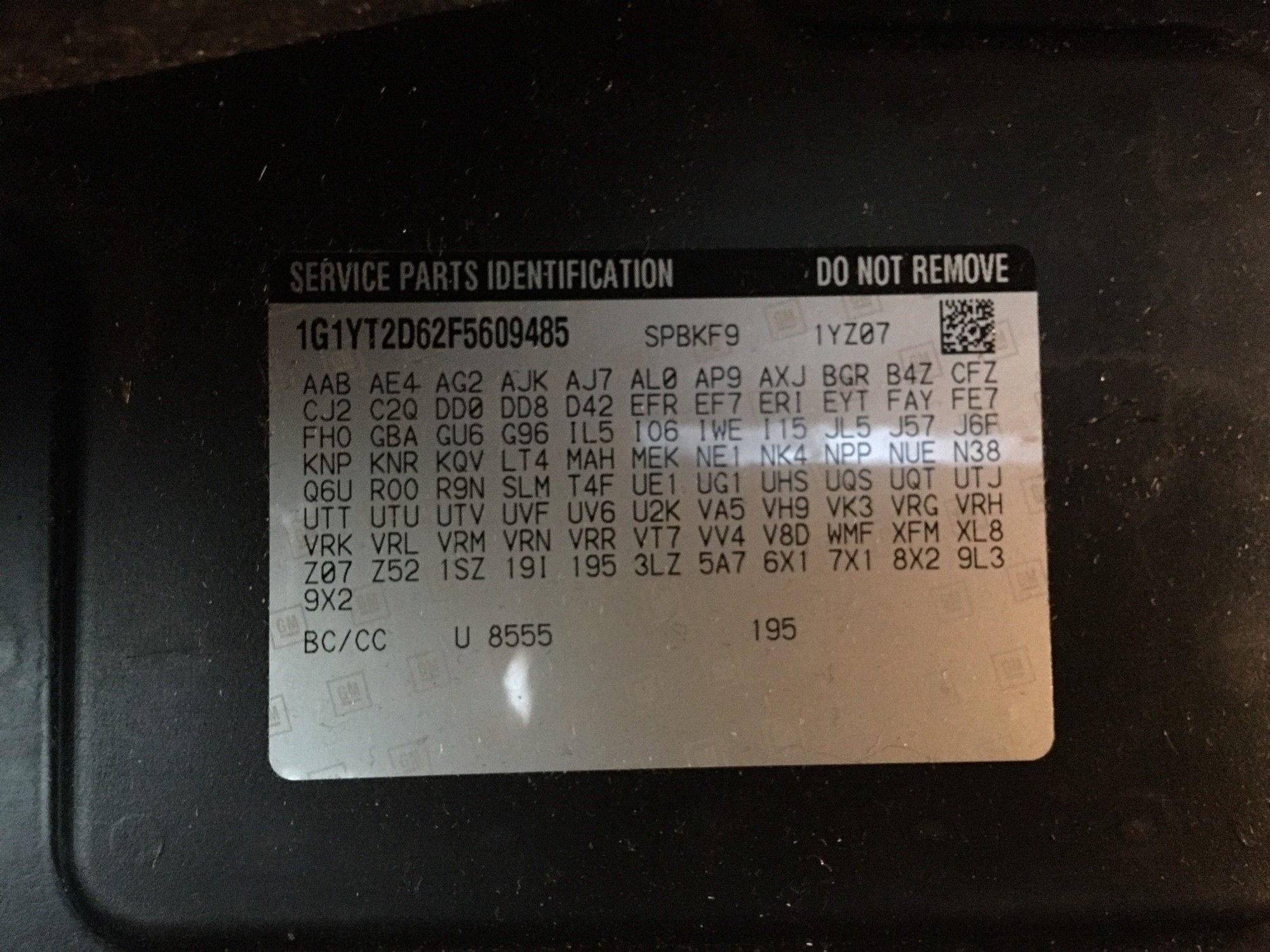

The first question is does your car have magnetic ride control? If it is a Stingray without Z51 it more than likely doesn't have it. If it is a Z51 optioned car it might have it although not all Z51s were sold with the Magnetic Ride Control option.
If it is a 2014 through 2017 model you should be able to find GM's Regular Production Option codes that are shown on the RPO sticker. In 2018 or 2019 GM put that information online and there isn't a sticker any more. If your car has a sticker it will be located next to the rear electrical center which is accessed by carefully pulling up the rear cargo area carpet so you can see the electrical center in the middle of the area. The RPO sticker looks like this one which is from my car:
If you have a Stingray you will see FE2 for magnetic selective ride control. This option was only available with 19 inch front /20 inch rear wheels. You could also see FE4 which also includes BZ4 which is performance traction management. The wide body cars such as the GS and Z06 come with FE6 or FE7 codes which include magnetic selective ride control and PTM.
Bill
