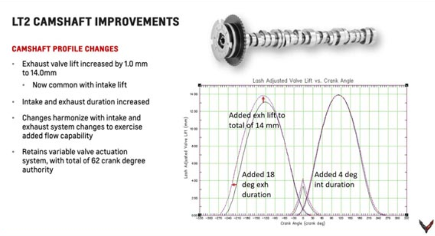

I am guessing that the C8 cam is slightly more aggressive than the C7 cam. Does anyone have the specifications of each?
I assume it would be a great cam to install in our C7 for a pick up of about 30-40hp.
Ken

The HP gains in the lt2 are going to come from a combination of the cam, the intake manifold, and the header design. For the trouble of install, you'd be better off going with an aftermarket cam.

Its probably only a slight difference, and other things are adding in to get the power number, such as the exhaust and intake manifolds.
If you are going to the expense for this, go bigger than the factory cams.

Take an LT1 and then add headers and a tune , guess what you get ... 35 to 40 HP , I am confident that this is what was done with the LT2

If you want to add a cam to your LT1 you probably want more than just 1mm (.039") of lift added to the exhaust side.
