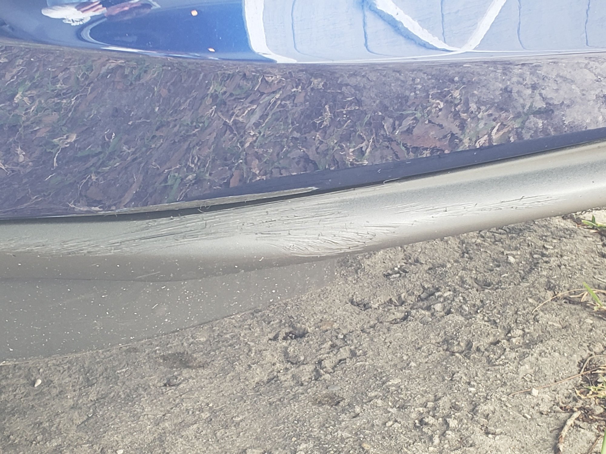

I bought my GS with some minor damage to the front splitter and lower center air deflector.

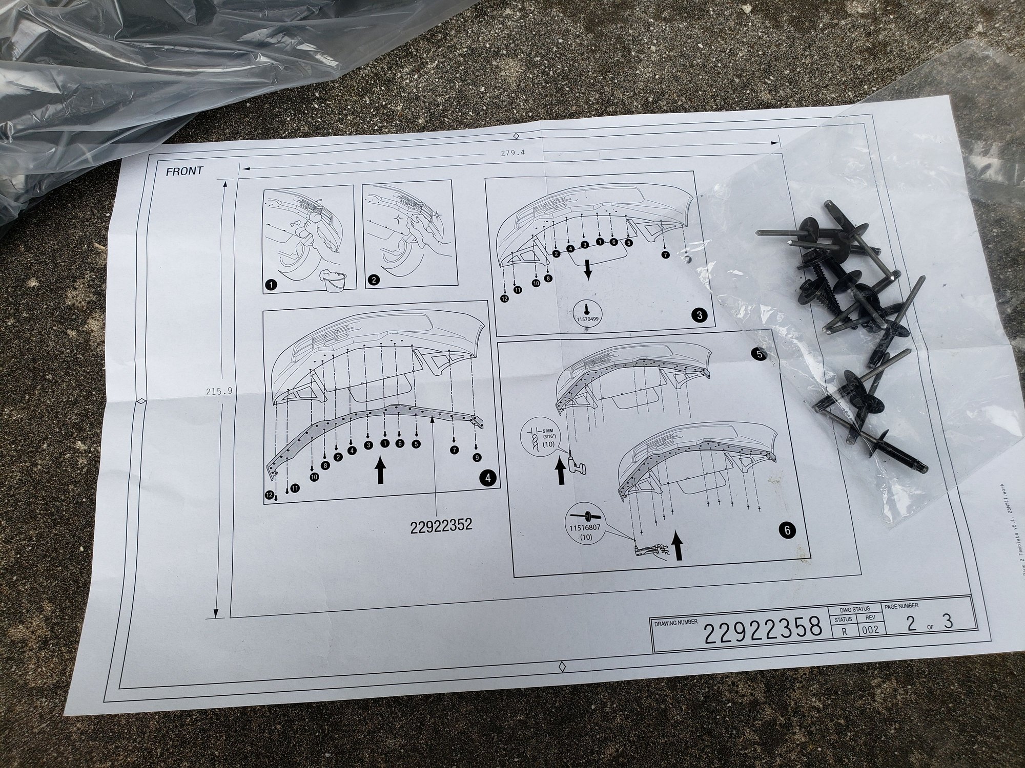

I went to Chevrolet and bought both parts. The splitter came with rivets and diagram. I used all the old screws.

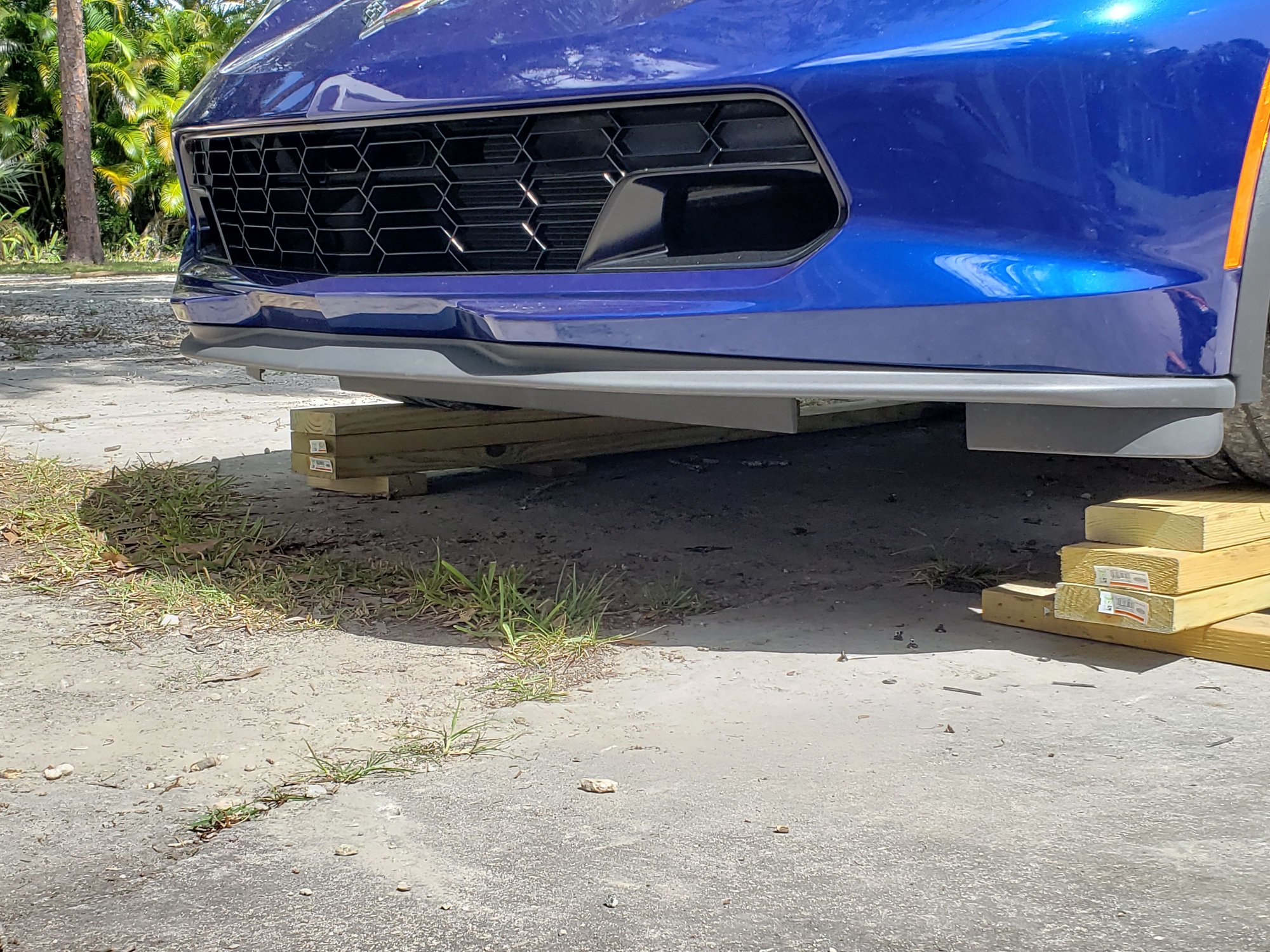

I used a 7mm socket, drill, and rivet gun. Was really easy. Easy after I built "ramps" 😁
Scratched it pretty good including the blue part of the bumper. Can't really see it though

I don't really have any good place to work on it, so I make due with what I have.
I drilled out the rivets first then removed the screws. I simply reversed the order and saved myself whatever the dealer would have charged.
I'll put the savings towards new tires. 😁
*edit* I posted this only to show how easy it is. I was nervous when the directions say to drill, but it is only for the rivet heads. My "ramps" gave me 8" of clearance and is plenty.

As my post says, I had a about 8 inches to work with with the ramps. I did not look at other splitters. I used a regular rivet gun that has several size attachments. It's easy.
