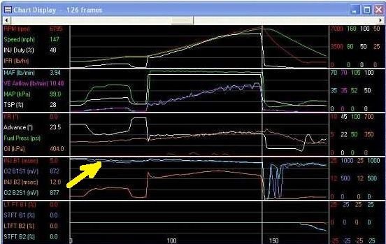

Default Fuel Trims
LTFT & STFT zero out during a power run like they should (highlighted with arrow)
Did you mean to post this as it has nothing to do with the thread
Dave
Dave
Has to do with the title, long term and short term fuel trims are monitored during street tuning, but not always, you eventually trust them to do their job like in the scan above
I get it but if you read thru the post this problem had nothing to to with the ECM adjusting and everything to do with a cracked plug and a air leak at the header flange ....
Dave ....
Dave ....
While that may be the case I'm just demonstrating where LTFT's and STFT's come into play within HP Tuners, during the scanning, street or dyno same, when you go WOT, they cancel and you are relying on your PE tuning NOT fuel trims any more, until you are off the gas...this you can see as the trims are zero across the board [from the arrow]

Default Oxygen Sensors
Just to finish my train of thought, here you can see the 02 sensor plot, is very inconsistent - this is before tuning, as the plot should be even across the run
In OEM tunes, LTFT's are considered when you go into PE and only STFTs are ignored.The only way LTFT's are ignored in PE mode is if they were specifically tuned that way.
Right, I didn't mean to imply the long term trims were not already tuned, I assumed this, so yes both happen to be zeroed in this case, for different reasons..
