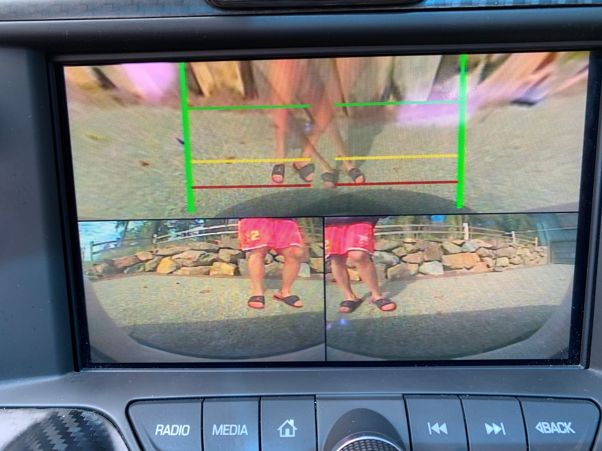

hi, guys, I just changed a new bumper for my c7, and the front camera is like this now, do u guys know what's the problem of this? Plz help me, thank you!

If you moved the cameras it appears as if the right one is either not fitted correctly or loose.

I changed a new bumper, do you think cuz I install the camera on wrong side
