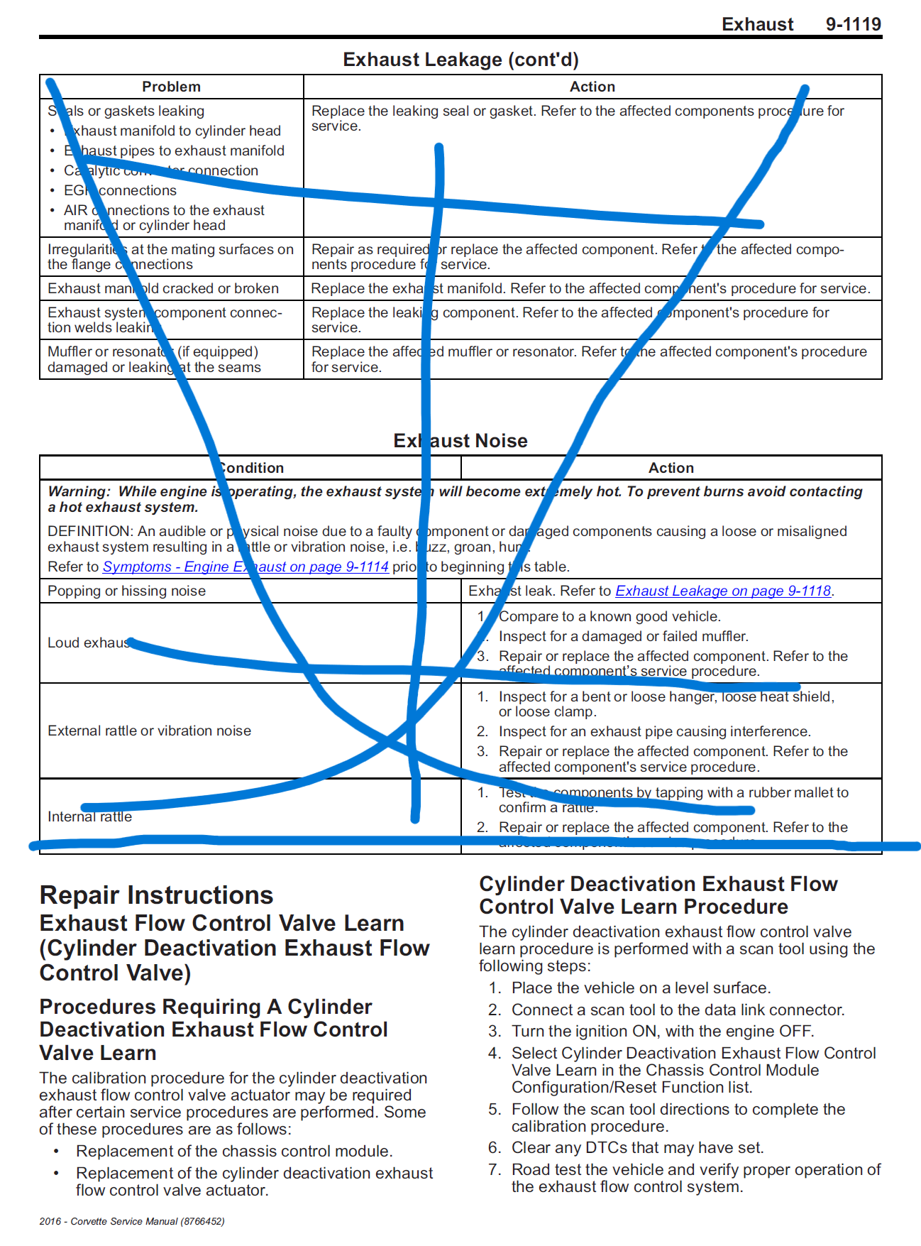

Here is the procedure for calibrating the CCM to recognize the flow control valve positions. There isn't a lot for a mechanic to do and if it doesn't work the only things that can fail are the CCM, the wiring between the CCM and the actuator or the actuator.
I would look for poor connections. Spray electrical contact cleaner on the connector pins and see if that helps.
Now I do know from personal experience that sometimes the calibration procedure doesn't always work on several subsystems. Sometimes the mechanic has to redo the procedure multiple times and sometimes a procedure may only take a few seconds to a few minutes to finish while other times the same procedure can take over an hour.
Bill
