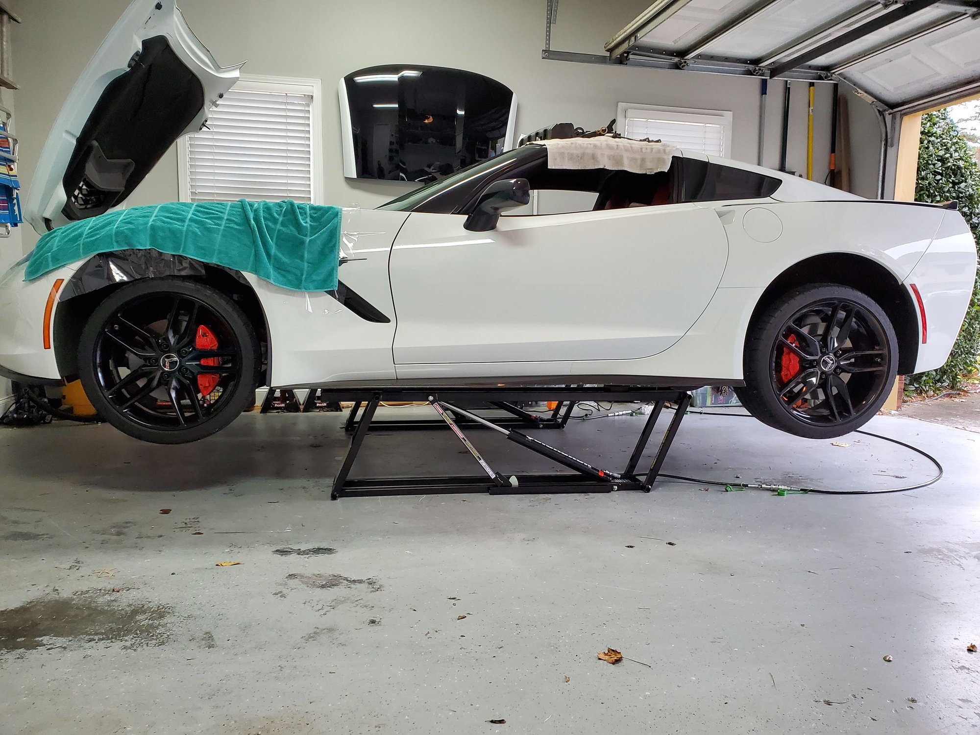

Also, do you know if a lift is an absolute must to do the header install. Iam not afraid to putting my car on blocks and sliding in and out for hours. I just don’t want to feel rushed on a lift?

Quick Jack made it easy for me , u could do it on Jack stands but it was nice to be able to lift it up and put it down when the need arose
