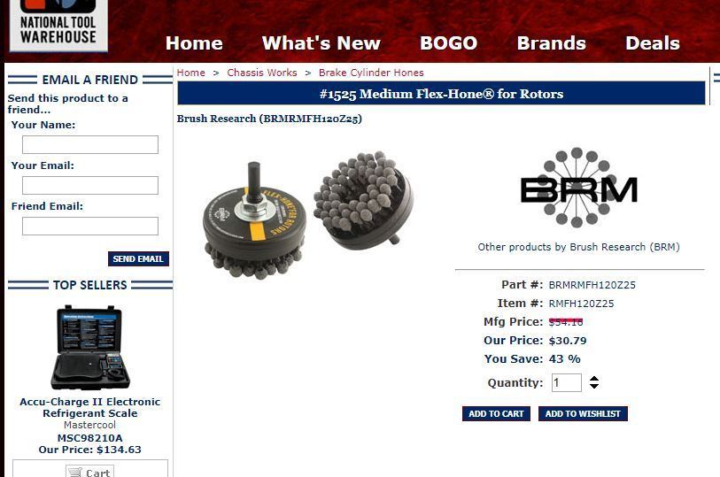

If you want to improve the surface much like a turned rotor without removing the rotor use a Flex Hone (available in fine, medium and coarse grit). They work great and put a nice non directional pattern on the rotor and give the new pads a nice surface to bed into. Be sure to clean the rotors after use.
