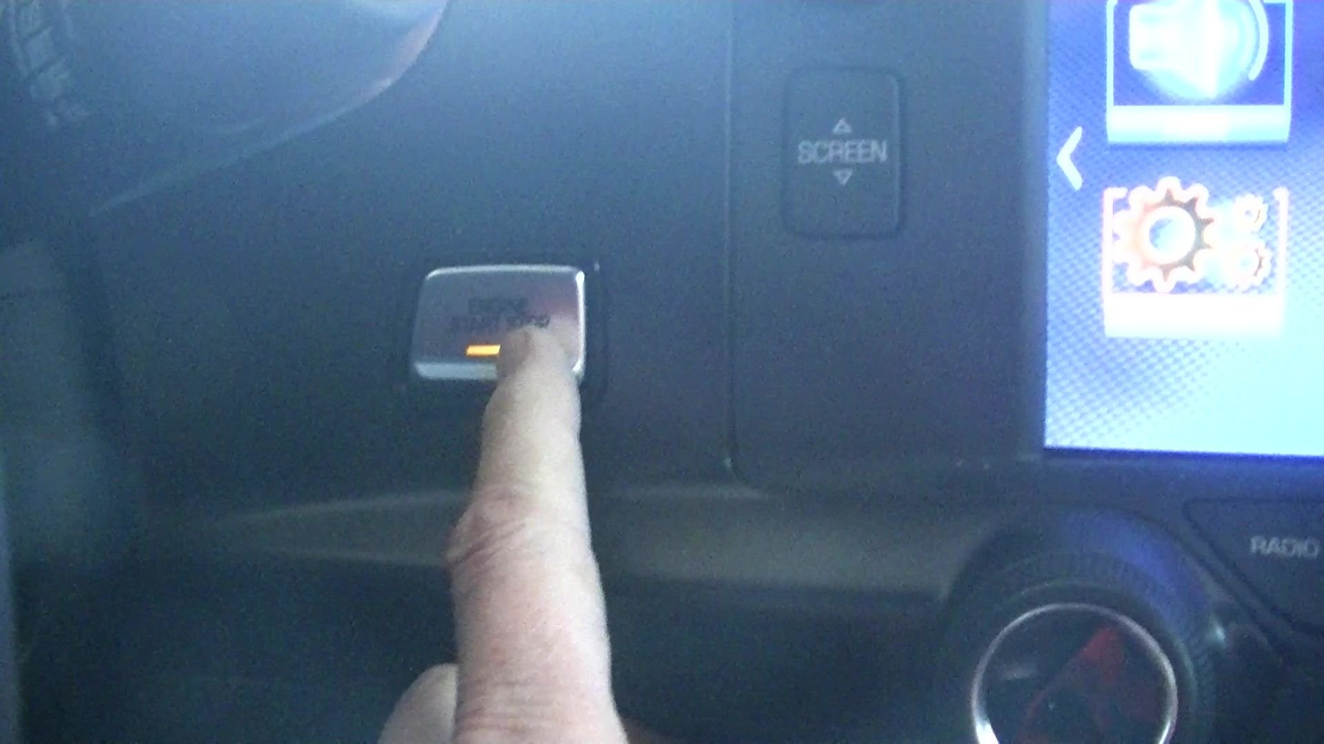

Default Start Button blinking red update (pics)
Normal modes. When it goes red, the lettering lights red and the whole button appears to be back-lit in red.

There are only three LEDs in the switch: red = backlight, amber = accessory, green = start. The backlight is controlled by the BCM along with a whole slew of other backlights, so if the start switch was flashing red a) the BCM may be getting a varying brightness command and b) many other backlights should be flashing as well.

If you are referring to the fob, no lead is required. It's not radioactive. Just use a couple of tin cans that form a complete enclosure.
The start button cannot be the only one flashing. That's not electrically possible.
