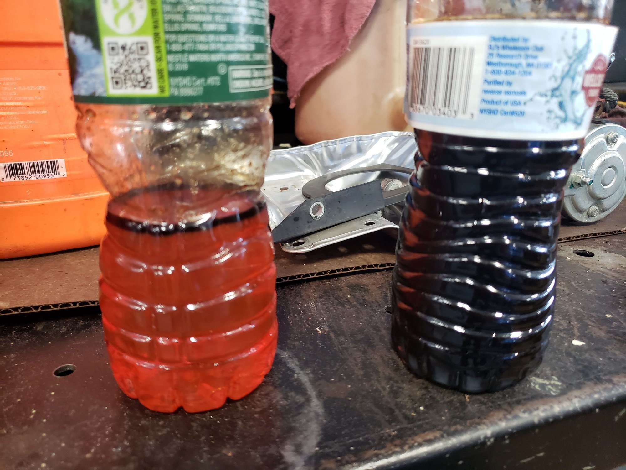

Just back from the dealer
Catastrophic engine failure. No engine codes in memory
350 amp fuse at battry blown
no visable fluid leaks. The front facing oil drain plug drains oil normally The second plug to the side drains pure antifreeze. See pic attached. Flywheel only turns about 180 degrees then stops
i changed plugs and wires 2 weeks ago and disconnected only the negative battery terminal before messing with the underhood fuse box. Everything went back together without problem and staref right up as normal
Did I screw up the elrctronics? 250 trouble free miles after the plug change.
im at a loss to explain this. Is there a direct replacement crate motor available from GM performance? The ones ive seen are meant for pre 1976 installs.
Also car is at Lester Glenn chevy in Toms River NJ.
Can i trust them?

That looks very much like what happened to me. Seems a common issue.
thanks for sharing
