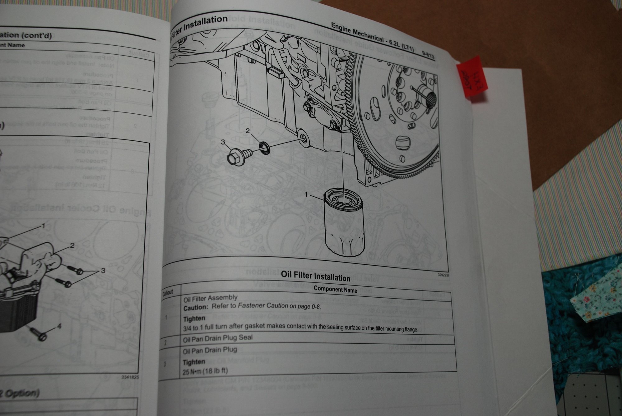

Originally Posted by 80atez
Elmer, I never want to start a thread war with you or any other guy named Elmer... But I gotta say, unless you're Popeye on Spinach, hand tightening an oil filter is not what I've ever heard to be correct on any car. The C6Z06 shop manual is how I came up with the torque specs for the filter for my car if I remember correctly. But that was 12 years ago... Maybe it does say hand tight. I'll recheck. But a 13K$ motor deserves some specs for a filter. I just do what I did prior, and if not prior, then by the book.
I wonder if the variable pressure oil pump can maybe not tighten the filter with time the way every other engine I've owned has...?
From the Helms manual Page 9 - 813
What can I say?
Elmer

Elmer doesn't lie. I did have to crack the book myself to confirm I wasn't losing it..
My 2008 shop manual pg 9-468 calls for 30nm / 22ft-lbs for the oil filter for the 7L and 6.2L (LS7 and LS3) from 2008... So we were both right! I personally much prefer actual measures than qualitative guessing by hand. And I never really know exactly when the gasket hits the flange. I also think torque setting are "usually" to prevent over tightening, not under....
I'm a bit surprised GM went away from that for the C7.
I've never had to drill a filter off. And I've never had one come off that I put on. Tightest I have ever dealt with was OEM new filter on a 5.7L 2012 Jeep. They really didn't want that filter to leak from the factory!
