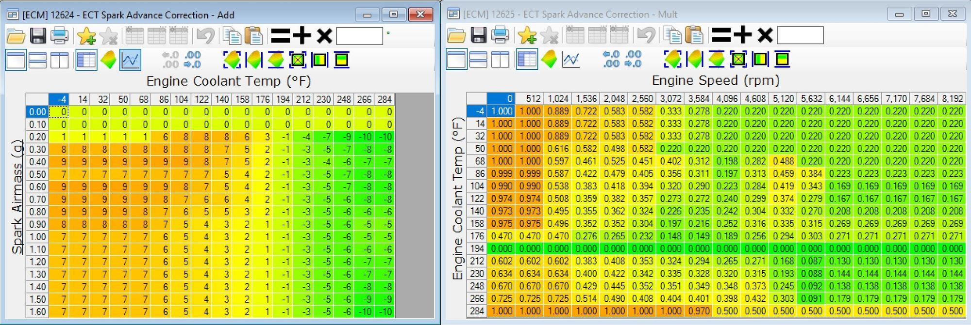

The coolant advance changes aren't as large as some may think based on the graph on the left. The multiplier on the right hows that between 175-212 degree F, the ECU only adds or subtracts up to .3 degrees.
I've never quite understood the graph on the right and tend not to believe it as real life scenario has shown my friend losing a lot more power than it states.
For example. From 212 to 248 it only shows 3 degrees of timing loss on the left. Is that equal 6-7 mph on the 1/2 mile? But if you include the graph on the right. It's less than half a point of timing. No way! His car basically lost the 75-100 hp advantange it had to mine once his coolant got above 240.
If 1 degree of timing is only a handful horsepower, he must have lost a lot more...
Without datalogs its a guess. But can absolutely tell you that the table on the right is a multiplier table and it applies that to the value on the left. For example, if your coolant temp is 194 degrees the left table shows -1, but the right table shows 0. This means -1 x 0 = 0 so no timing is added or pulled.
Go to 212 degrees. The table on the left shows -3 degrees, but the multiplier table on the right shows anywhere from about 0.3 to 0.13. So at lower rpm you will see .3 x 3 = 1 degree pulled, then as you get higher up in the RPM's you see -3 x .13 = .33 so you get -.3 degrees.
Anyway this isn't the only spark modifier table that is referenced. But I can guarantee you that you won't see a lot of timing added or removed from coolant temps. It's very minimal. If your buddy is losing 75-100HP and 7 MPH in the 1/4 mile, its not from the coolant temp spark modifier.
Half mile distance. Race track. He was losing speed each lap as his coolant increased. His IATs are good.
Only thing I could tell by PDR at least. And I can absolutely say that my old car (procharged c7 z51 which IATs were great) was an absolute dog on the track once coolant temps rose. Maybe it looks at oil temp too since that rises linearly with coolant on these cars
