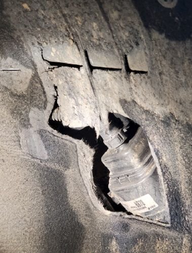

Let's be clear. This is NOT from rubbing. This is from track debris & road debris going upwards through the liner. Happens to my S560 as well from highway driving. The liners are just garbage.
On my Z07, it's OEM sticky tires.

I'll say that it's both rubbing and debris depending on setup. I have aero and unfortunately the Z07 springs aren't up to the task when I crest and then come down on the other side of a rise in the track. My front liners clearly show 8" long rub marks and they have the typical debris shots as well. The rears are the same. .....6-8" long rub marks as well as holes that are clearly from debris shooting through them. I just keep patching with fiberglass screen stitched in with Zip ties and covered with spray on bedliner or flex seal. Once they're too far gone, they get replaced.
My 2013 Grand Sport had rub marks and debris holes in the plastic liners. My 1996 Grand Sport just had some debris holes.
The liners simply weren't designed for any sort of regular track use. I'm sure weight and cost played into Chevy's decisions, but I will also say that it seems like the liners could have been shaped a bit differently to help.

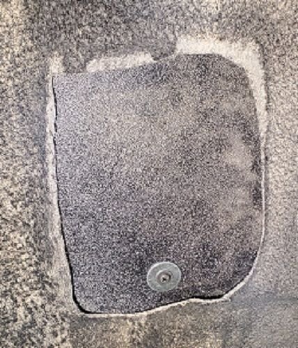

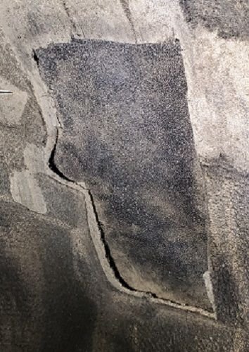

I bought my GS used, So I don't know it's history.
While pulling rear wheels, looking for nails (it was cracks and nails), I found all the damage to this "compressed dryer lint" wheel well.
Since I'm fixing a half-dozen frustrating things that generate new cus words, I found this.
Take THIN Haircell ABS and make a patch until your budget will allow for a new set of compressed dryer lint.
The ABS is thin enough to cut with a big pair of scissors and strong hands. Trim to fit, tuck it in behind.

Since it's temporary, I used a couple of squares of 3M emblem tape. There was nowhere to screw that particular piece into
On the other patches, I used a speed nut and 8MM screw.

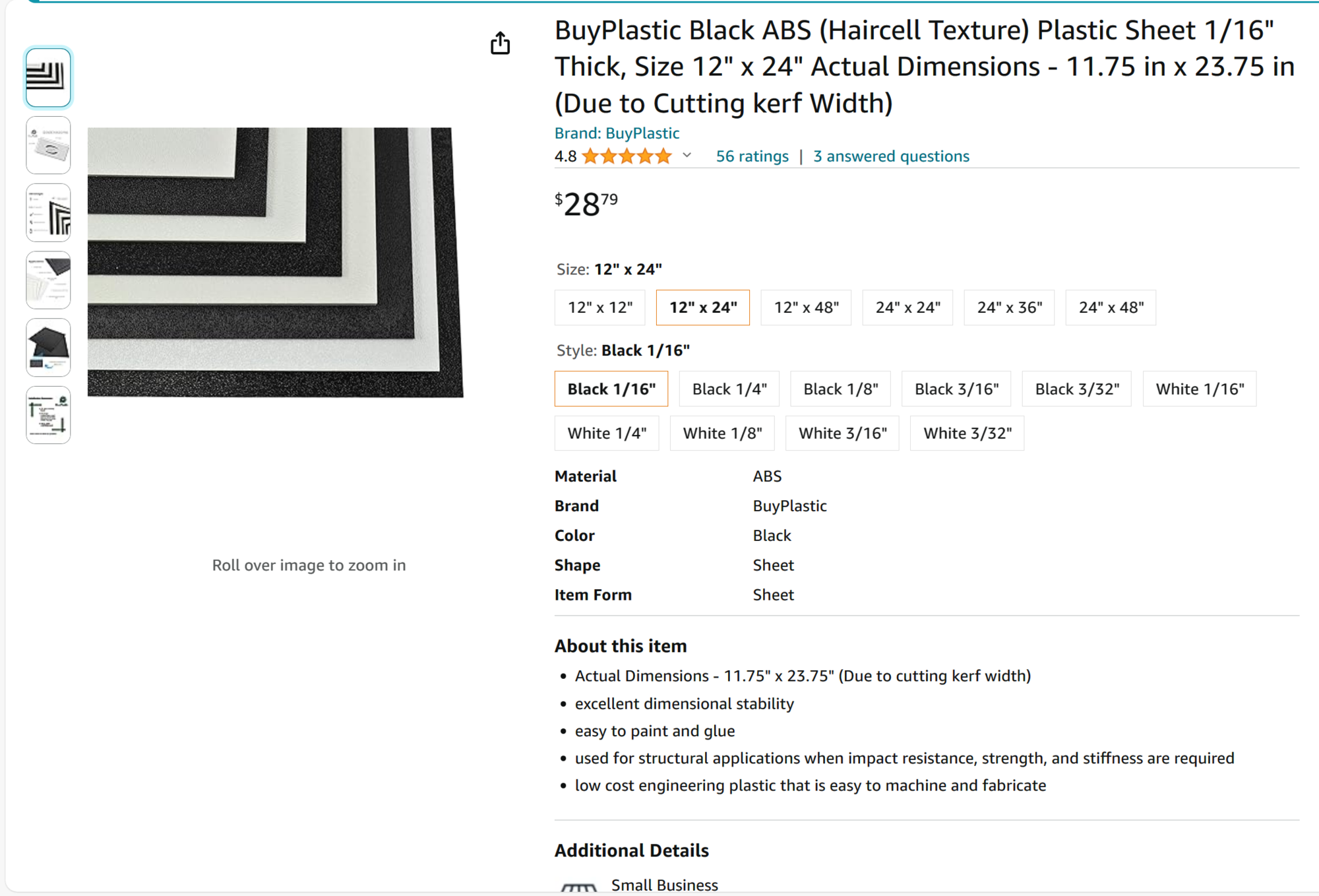

Amazon shows the product comes in various thicknesses. When you say THIN how thin do you mean? I suspect it isn't 1/4 inch or 3/16 but are you going with 3/32 or 1/16?
Bill
Old Jan 14, 2024 | 02:49 PM
  #50
MSGT-R's Avatar
MSGT-R
Joined: Oct 2013
Posts: 627
Likes: 119
From: Denver CO
1/16th.

This is what I ordered from Amazon:

Yes, I was referring to the previously mentioned use of 1/16" ABS plastic. If the material held up then I imagine one could find a method of attaching it that worked. Not just patching a hole but covering a wider area in advance. I'm going to be installing a brand new set soon and would like to reinforce them prior to installation.
Old Apr 26, 2024 | 12:24 PM
  #57
jacobe38's Avatar
jacobe38
Joined: Aug 2022
Posts: 138
Likes: 13
Amazon Amazon
This is also a product I've looked at - i know that people in the drifting community use this for fender liners. I think the challenge would obviously be forming/attaching to existing liners in such a way that doesnt allow tire rubbing. And, even if the patch is strong, the patch could just rip at the attachment points. The original OP of this thread said spray on bedliner didn't work, but I didn't try it.
