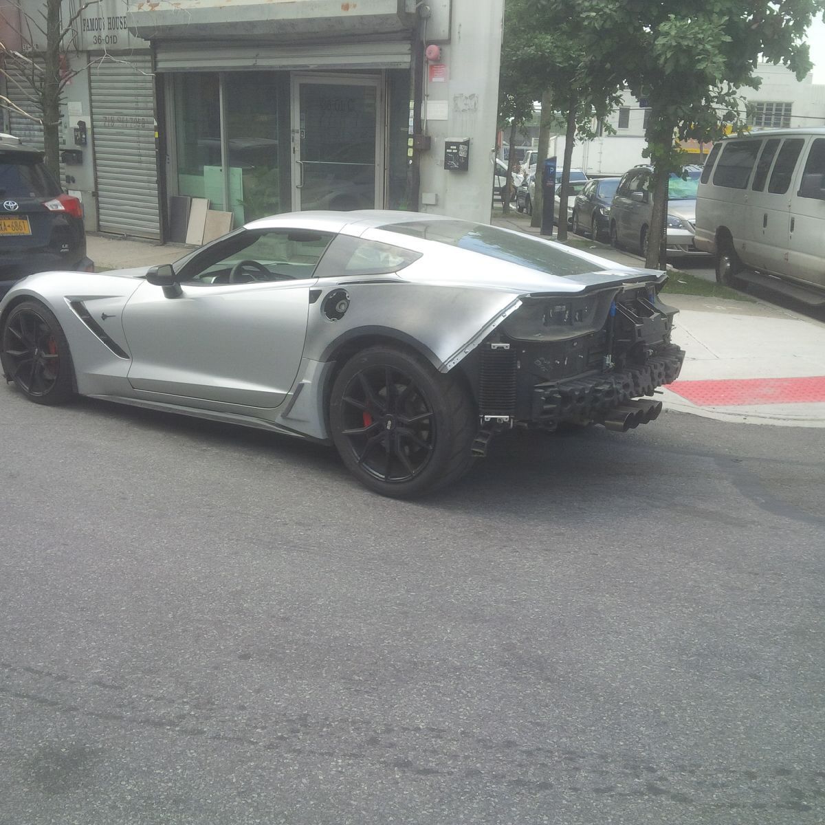

What's up everyone. So I have a 2014 3lt z51 with some bolt ons and a supercharger with a built engine waiting to be installed. Also...the look of the widebody vettes are just much better IMO. Therefore I decided to pull the trigger and do the conversion. I'm sure many of you have seen a few cars that have done it already and posted the DIY instructions. This is NOT A DIY THREAD. Just wanted to give another option for those looking to do this.
So far there's the weapon x route/piecing the kit together yourself which yields the same labor for install.
OR you can do the ACS rear conversion. I decided to do a mix of both. Since I wouldn't have been doing the work myself in either scenario I purchased the front fenders with inserts, rear quarters with inserts, rear fender liners, rear bumper cover and z06 wing all from a forum member for a great price. Then I purchased the ACS lower scoop for the wide body conversion that they sell (I purchased the lower scoop separately) and front fender liners.
I opted to not replace my lower aperture which I suppose is the right way to do this. However, i just didn't feel comfortable doing that. So....when doing the full conversion without the z06 lower aperture/rocker panel you run into two issues which I was already aware of.
1. The front fenders don't line up perfectly towards the bottom

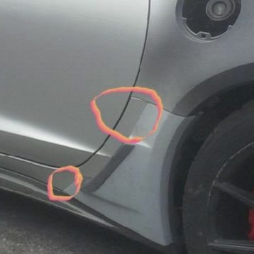

2. The ACS Z06 scoop leaves a very noticeable seam where it is joined.

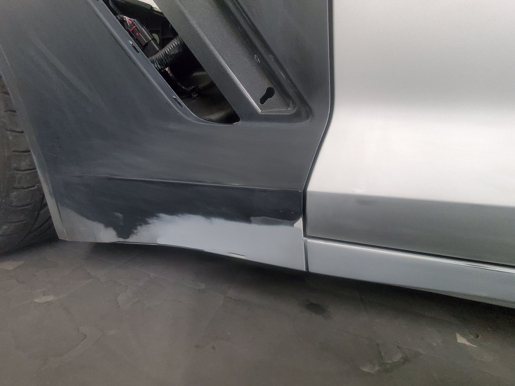

Now on to the solution....for those who may or may not want to. I had my body shop mold the ACS scoop and cut and re-work the lower portion of the fenders. The car should be completed in a week or two but here's some pics so far. (Some are terrible quality sorry). Also! Please remember this is no where near the final product. Still lots of sanding and measuring to do.

Those lines which would be the ACS downfall IMO

Here's how the front fenders line up to the stingray panel. If you force it up the gap just moves to another area...either way you'll have some sort of gap.

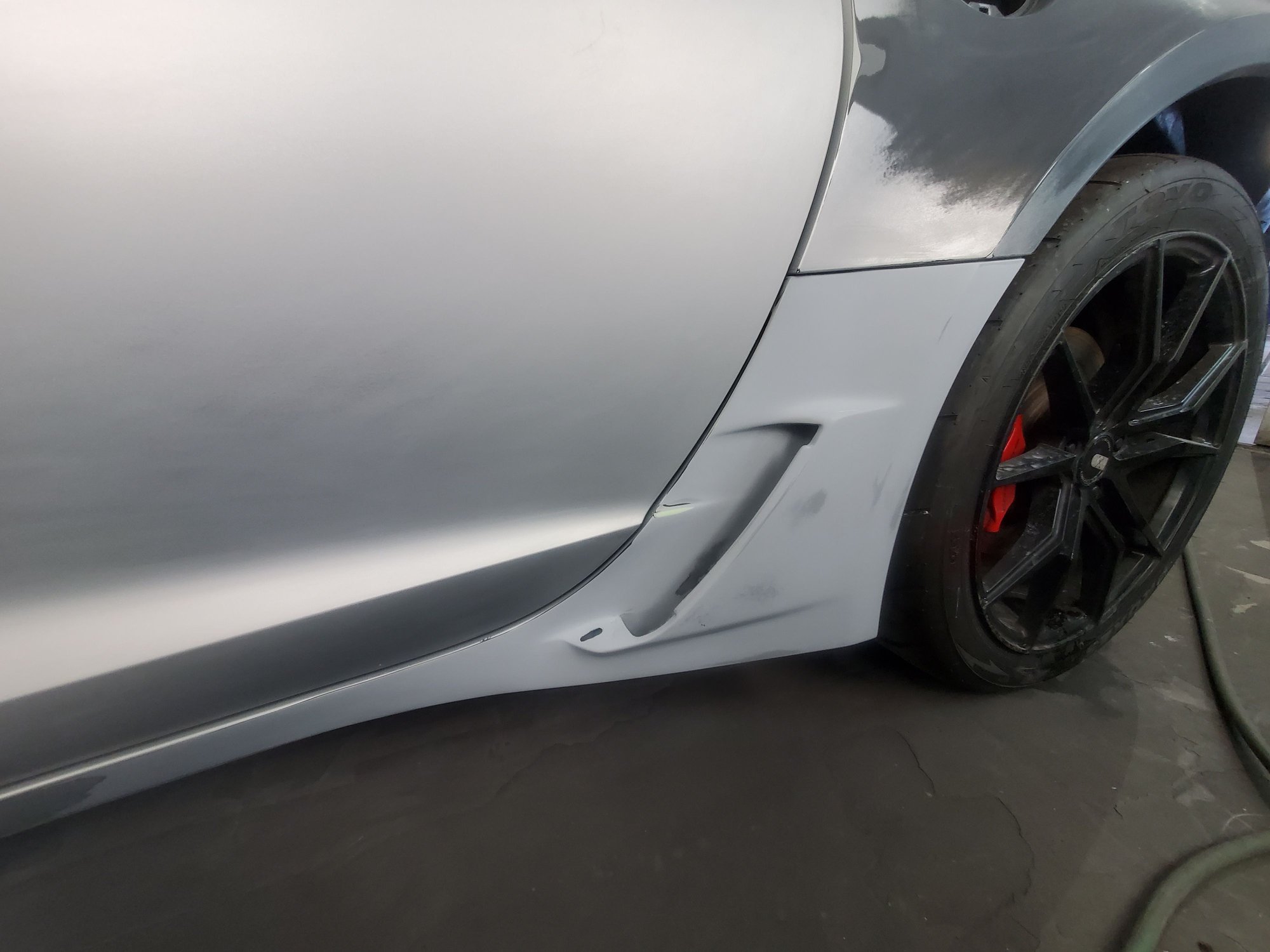

Started molding the lower section. I dont belive it'll look OEM. But i personally think it'll look good....lets see lol.
Front fenders in the process of being re-worked a little. Side skirts (who i also purchased from a forum member) were test fitted and lines up fine.
rest of the fender fit perfect.

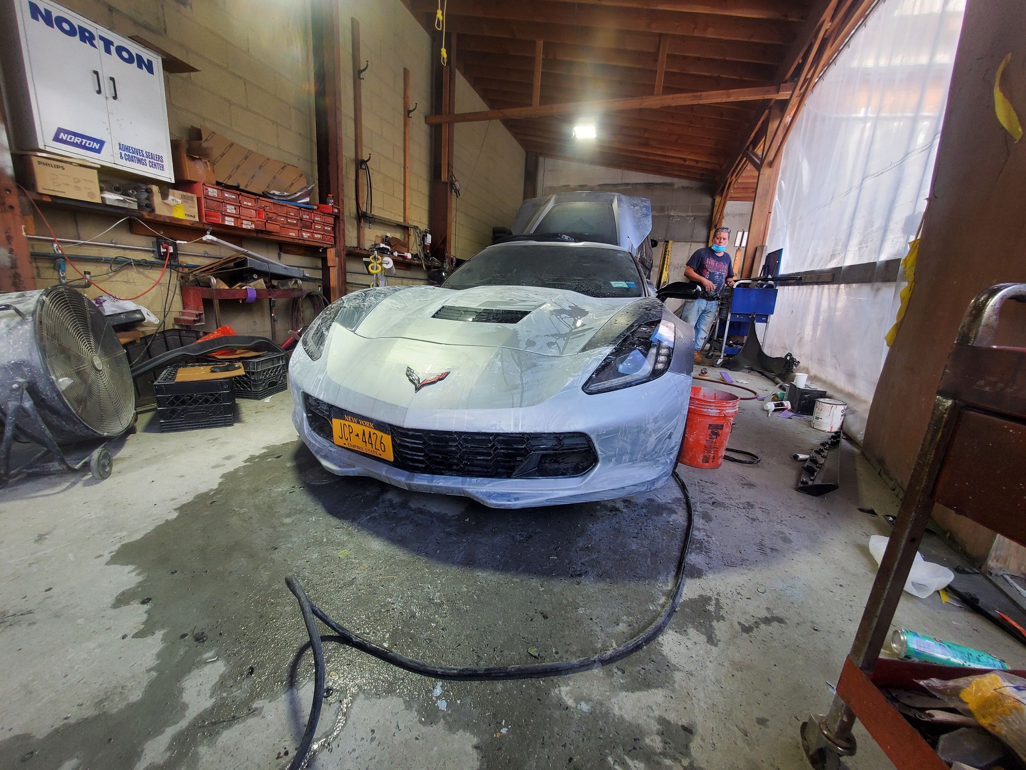

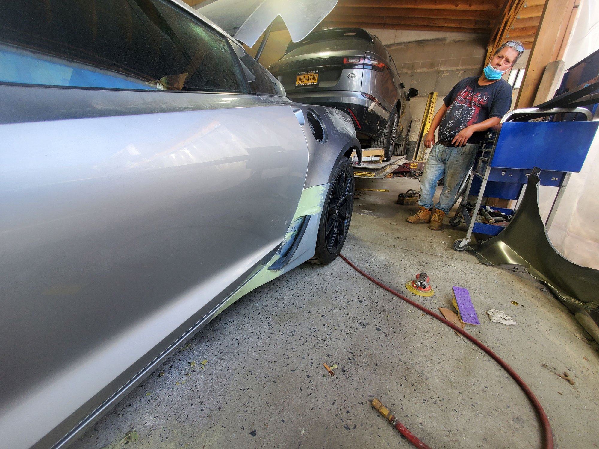

some quick updated shots. The car should be ready this week

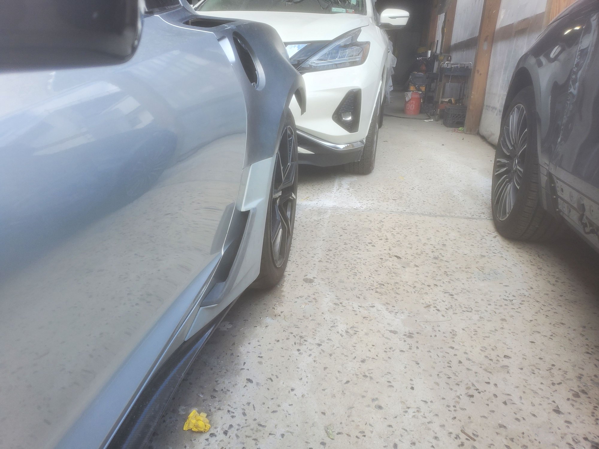

Man he did a really good job on that!

To C7 Z06 conversion....done differently
