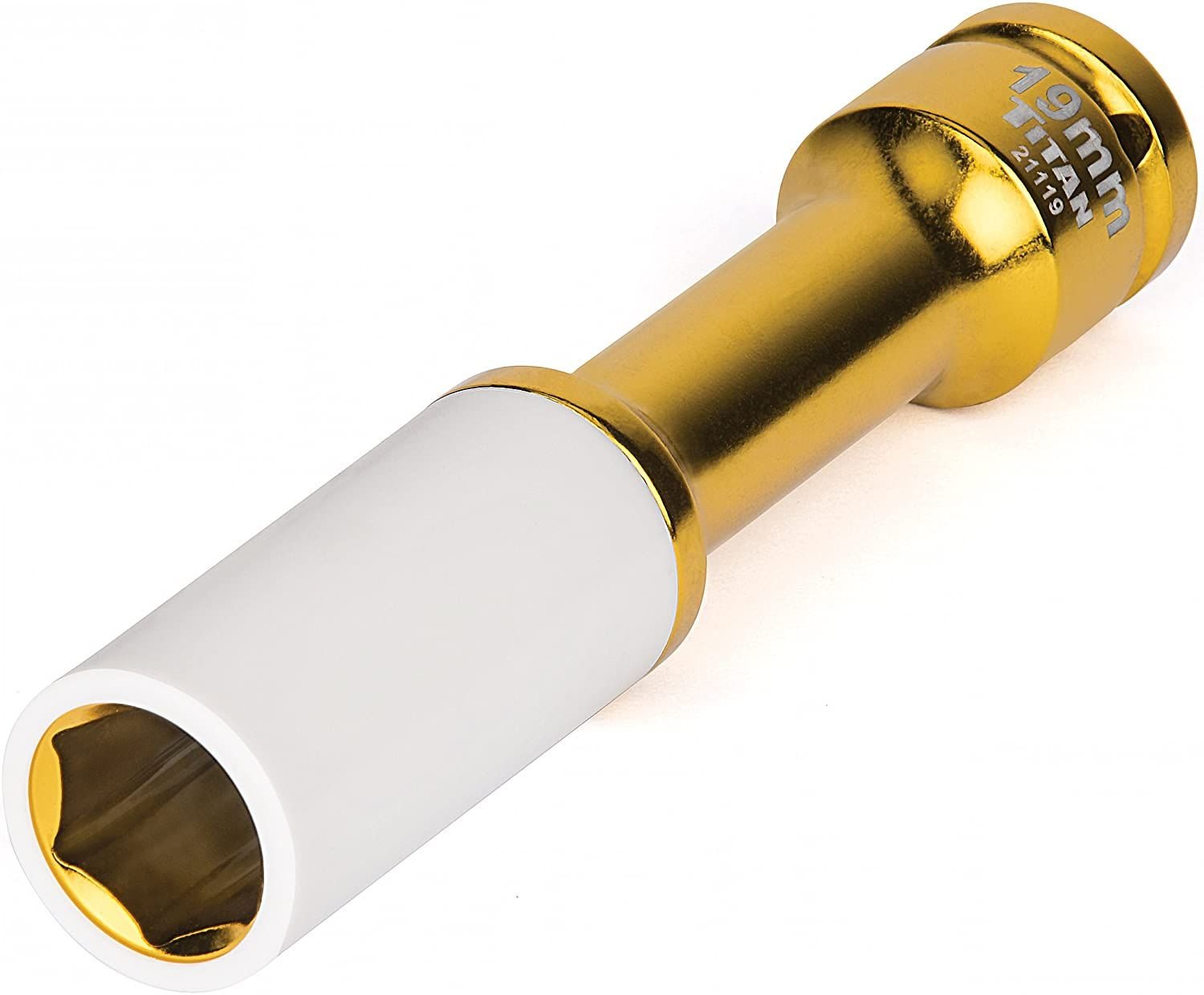

I bought this from Amazon:
Cheers,
MrHix
That is the one I was looking at.

PS Not for use with impact driver, walls are thin.
MrHix
What would you use if you want to use an impact wrench?
