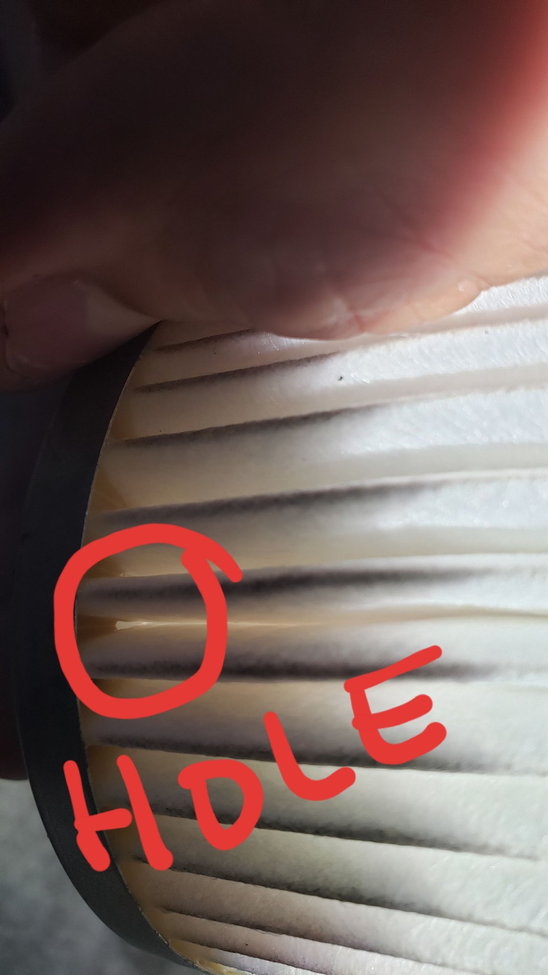

Wanted to warn people about this. I bought 3 of these wl10290xp filters to use on my LT5 engine. Better filtration, 22psi relief, yada yada...
Upon close inspection of the filter (as is customary for me) i noticed that the epoxy that holds the filter media only covers about 1/2 of the circumference. I then proceeded to open the filter. And sure enough, half of the filter media was not sealed to the metal "floor". 2 out of 3 filters were like this. So be careful.

I contacted WIX and they arranged to pick up the filter from me to do their own testing.
They said that they have not seen this before. I will keep you updated about this. I think it would be unlikely that I got all of the defective filters out there. I think there is a batch of them out.
Also fun fact, the color of the resin from the "good" filter and the 2 "bad" ones is different. Both "bad" filters have a light creme colored resin. The "good" one has reddish resin.

They may have seen it before, but the person you actually spoke to versus the person who's actually seen it are not the same. It's possible there was an issue with the resin on a production run. Luckily, the numbers stamped on the end of the cans give them the info to narrow down the date and time the batch in question were in. When they confirm the problem, they'll issue a notice to all their vendors instructing them to stop sale on whatever batch it was and return them to WIX.

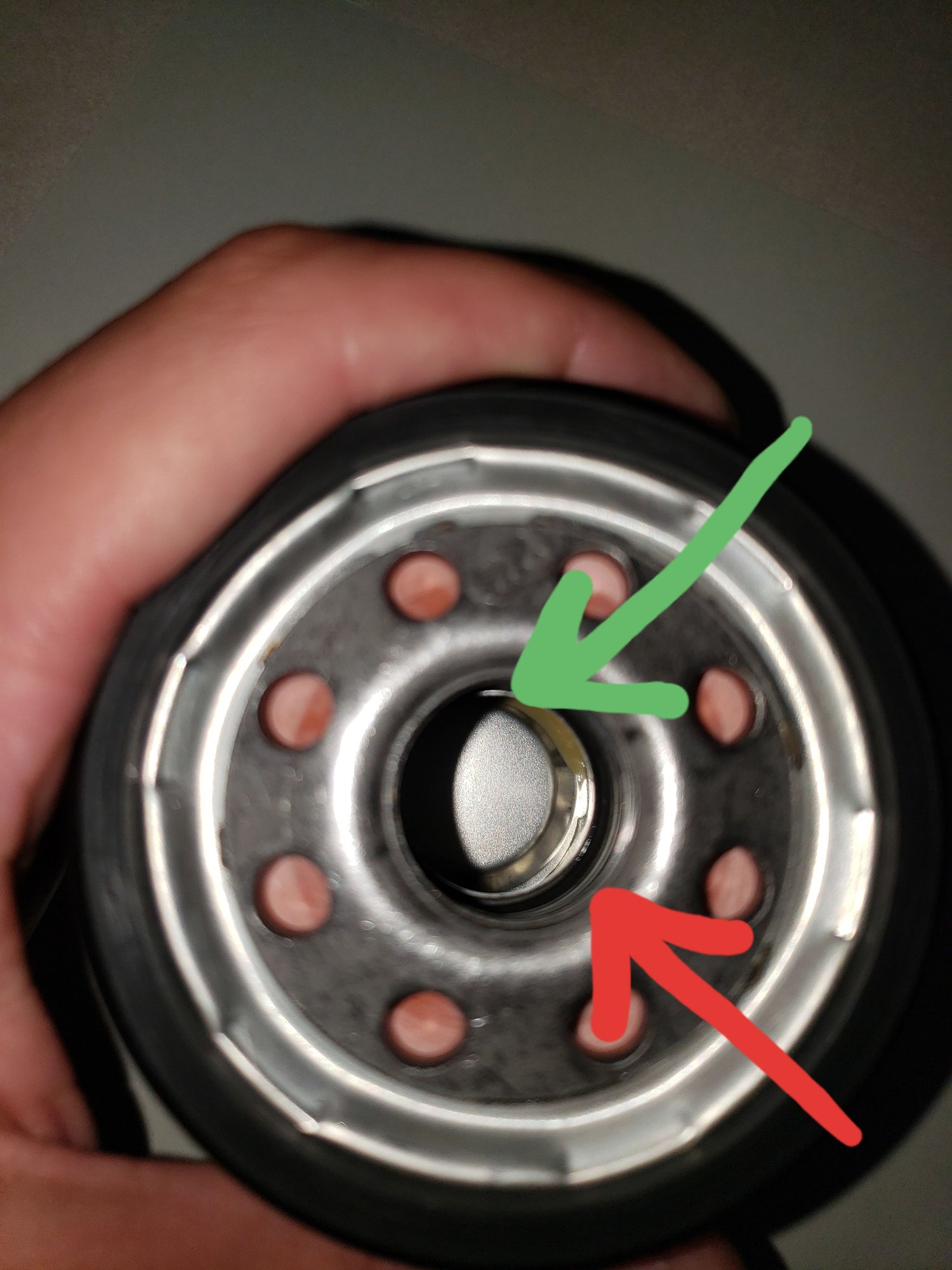

One other thing to note. I purchased a Wix WL10290XP to compare with an ACDelco PF64. I noticed that the thickness of the plate with the threads is thicker on the ACDelco. Looks like 3 grooves in the threads on the Wix and 4 grooves in the threads of the ACDelco. Not sure that is a problem, but it is a difference.
Since my car is under warranty, I decided to stick with the ACDelco.
