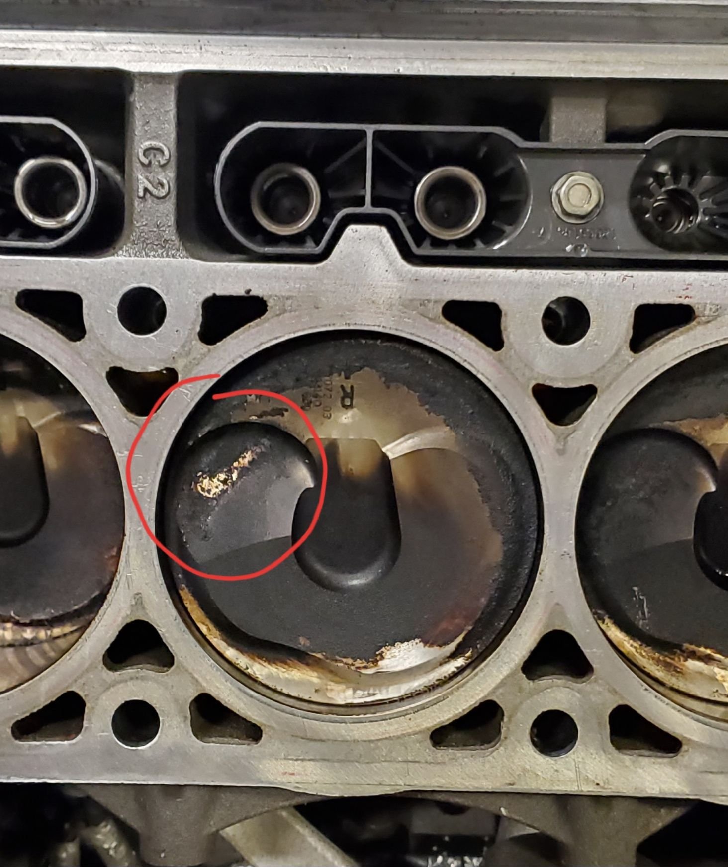

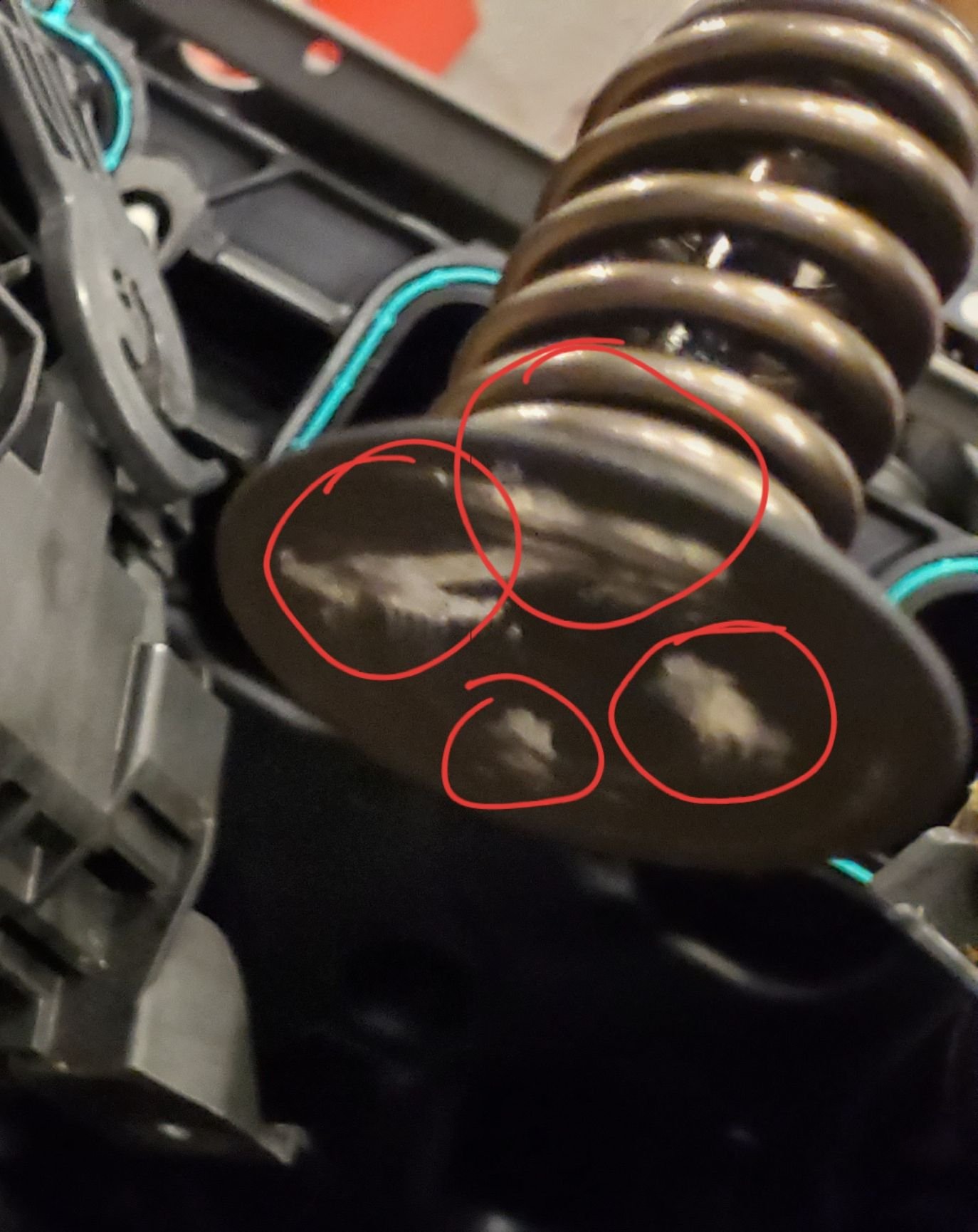

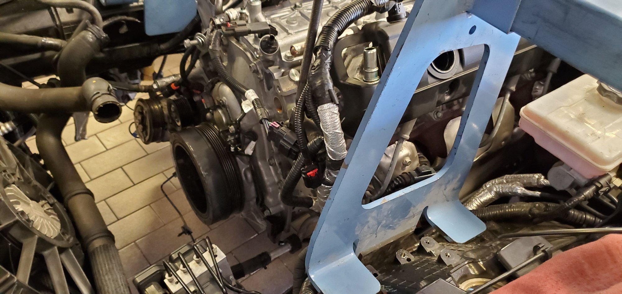

Took the car in for Airbag service light and a loud clattering coming from the engine between 1200 and 1500 RPMs moving, not in park. They fixed the passenger seat and cleared the codes for the airbag. Then they removed my cam and lifters and replaced them. That is when all hell broke loose, number six cylinder is now misfiring. They did a compression check once all other avenues where covered and found that number 6 cylinder had no compression. This is 2 weeks after receiving the part to do the job. I get a call from the dealer stating they need my car for a few more days. That is when they gave me loaner, a crappy Malibooboo. The tech removed the head from the side with number 6 cylinder and did not call me to tell me what he found. I think I know why, he did how ever ordered a new intake valve kit. The service manager told me he didn't know much other than my valve was bent. I asked how a valve can bend when the heads are on the bench and it wasn't a problem when I came in. Deer in the head light look answered my question. I am at a loss here I have never had to deal with this kind of stuff because I usual buy cars that I can fix myself. I went in today and manage to take some pictures of my car's guts. Tell me how should a proceed, opinions may help me figure out what to do.

The general manager sat down with me and the service manager and the technician. I asked him how the valve got bent and how the piston looks to have impact damage as does the bent valve. He claims the valve made contact with the piston during the timing setting. That there was no foreign debris in the cylinder. I was told the damage to the piston, the valve, and valve guide does not constitute a engine change out. They are only required to replace the piston, piston rod, valve and valve guide and hydro the one head. I am so tired of BS from everyone anymore. The seats passenger jell pack for the presence sensor leaked onto the carpet under the seat. It's hard to believe that something that is required by law is not required to last as long as the original catalytic converters. I am tired of fighting for every thing. Looks like I am going to fix my 1985 Trans Am and move the Vette off to some one that can afford to give it a home. Dam I hate these masks.

I feel for your pain - but the repair procedure is correct. There is no reason to change the block. That doesn't mean you should not be upset, but I would not want the block changed. No doubt the technician screwed up when timing the new cam but at least they admitted it and are making it right. There have been other posts here where the service department claimed no knowledge of how it happened and simply told the owner to take the car away. These guys screwed up but they aren't hiding from it.
