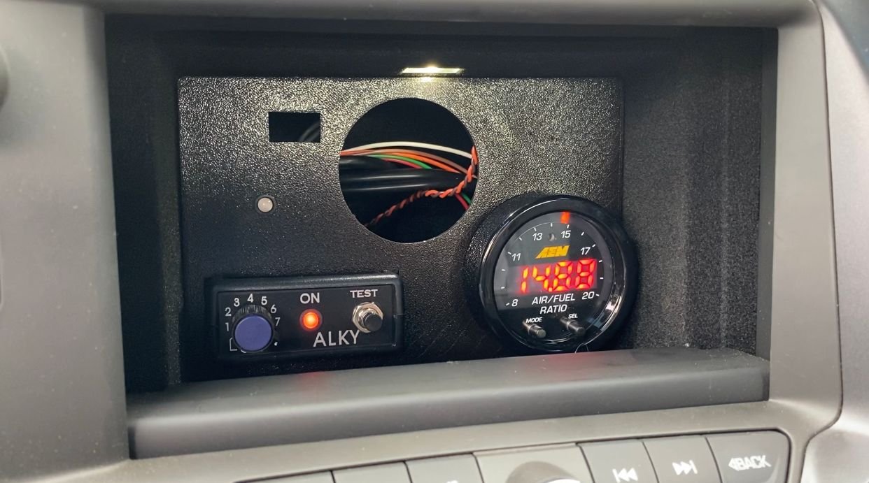

motojager's Avatar
motojager
Joined: Aug 2018
Posts: 682
Likes: 91
From: El Dorado Hills
Old Oct 18, 2020 | 03:20 PM
Chazzmania's Avatar
Chazzmania
Joined: Nov 2016
Posts: 769
Likes: 88
From: Ewa Beach Hawaii
Originally Posted by motojager
This is a clean setup, did you make this or purchase this somewhere?
Old Oct 19, 2020 | 08:00 PM
motojager's Avatar
motojager
Joined: Aug 2018
Posts: 682
Likes: 91
I made them, did one for a single gauge too
Are you making them for other people?
I remember seeing the single and you were looking on the double. I like it, it came out nice. Are you releasing the STL for it?
Did anyone have any luck finding this setup?
No luck I think the back when I commented the guy was making, but never heard from him if he was willing to make for others. I definitely like the setup
