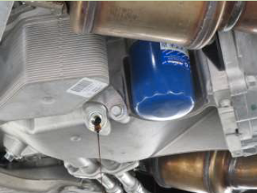

My AC Delco Oil FIlter is on so tight I can't remove it. Tried several different wrenches and the metal is bending. Now I'm afraid I'll puncher the filter and then I'll be stuck.
Any suggestions? Is it better Hot or Cold? Are there any special tools to remove a stuck filter. It was put on by the dealer at my last free oil change. I can't believe how tight it is.

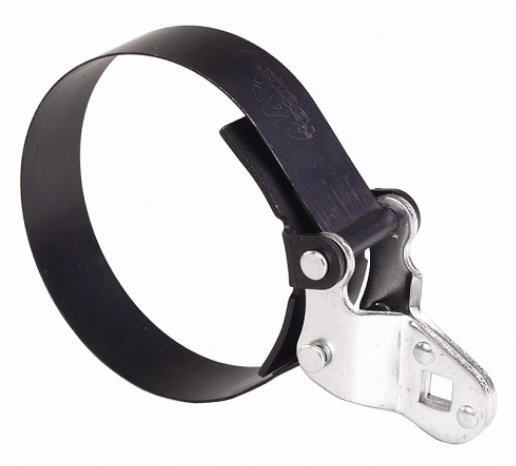

Try a strap type wrench as high up towards the filter base as possible. Be sure to get the correct strap for the filter diameter.

I have this type of wrench with a handle. I can't get up the body of the filter with the handle. Will this fit on my C7 GS Oil Filter? Is there enough room?

I've done that in the past with other cars but there is no room on a C7, 2/3 of the filter is surrounded by the Oil pan and the Oil Cooler and Exhaust is on the other side. I get it that they recess it so It's not exposed under the car but it makes removal difficult.

I would punch a screw driver through it at an angle through the bottom of the filter and out the back side. It only needs to break out the other side of the filter enough to grab and there is room for that.
You asked for suggestions, that's my suggestion.
If you can warm the car up, warm it up. If not, put a heat gun on it to heat up the rubber seal. The filter probably isn't on that tight, whoever installed it probably didn't lube the rubber o-ring on the filter so the rubber is stuck to the filter housing.

There is enough room to get the strap type filter wrench on and rotate a little bit at a time to loosen the filter. You use a long extension in the square hole.

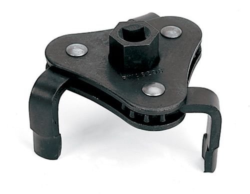

See post 28. Looks like this worked for one guy. A $10 tool from NAPA.
https://www.corvetteforum.com/forums...r-stuck-2.html
https://www.napaonline.com/en/p/BK_7769018

These work great had to get one for my car. Dealer must have had Magilla the Gorilla put the filter on

I use something like this every oil change but he says the metal is twisting. Best bet is the strap wrench near the base.
