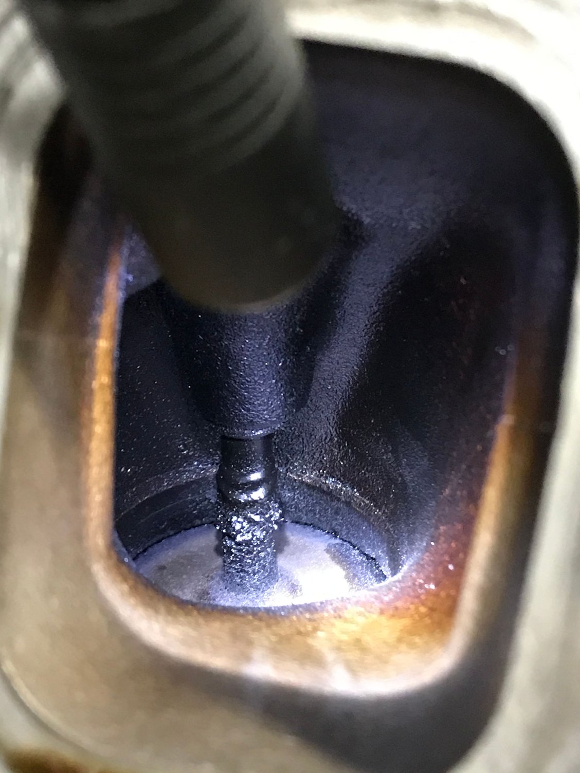

Old Oct 10, 2020 | 06:04 PM
RocksZC7's Avatar
RocksZC7
Joined: Aug 2015
Posts: 115
Likes: 31
This is what my Z06 intake valves look like at 60k miles. Car runs great with no apparent loss of power. Car is stock & my daily driver.
