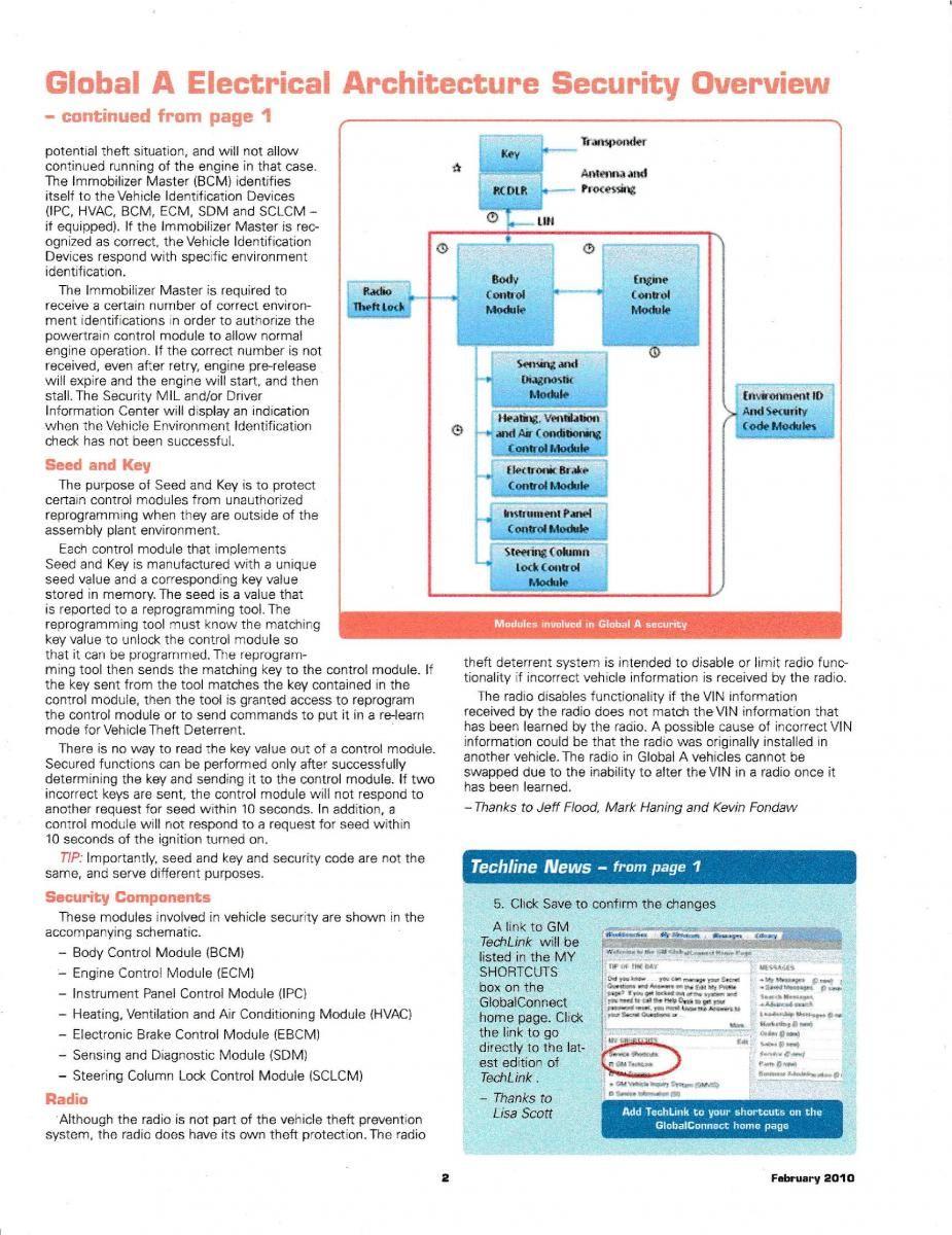

According to GM literature (see attached) the following modules are all locked to each other and communicate to each other to prevent vehicle theft:
ASDM - Air Bag System Diagnostic Module (also known as) SDM - Sensing and Diagnostic Module the name given to air bag modules used in General Motors vehicles
BCM - Body Control Module
EBCM - Electronic Brake Control Module
ECM - Engine Control Module
HVAC - Heating Ventilation and Air Conditioning Module
IPC - Instrument Panel Control Module (speedo cluster)
SCLCM - Steering Column Lock Control Module
Hence a used module from another C7 should not be installed because it will have a wrong "environmental ID" saved.
GM wants you to buy a brand new "virgin" module which will then be uniquely coded to your car.
But the Immobilizer Master (BCM) is required to receive a "certain number of correct environment identifications" in order to authorize the powertrain control module to allow normal engine operation.
If my interpretation is correct that means that at least one if not more of these modules dont need to have the correct environmental ID and the engine will start properly anyway.

Grump you have asked this question a 100 times and you got the same answers from me and another trusted member of this forum
Flash the BCM and any modules with your serial number using GDS2 using the GM TIS/SPS web site to get the files that belong to your car ...
That is the programing tool they are talking about above
