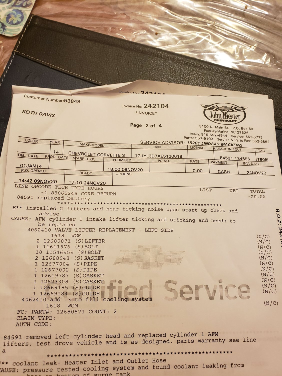

I just got my car out the shop today, They had to replace AFM cylinder 1 intake lifter, And they had to replace intake cylinder 7 AFM lifter, You looking at between $3,000 -4000. Bucks good luck
