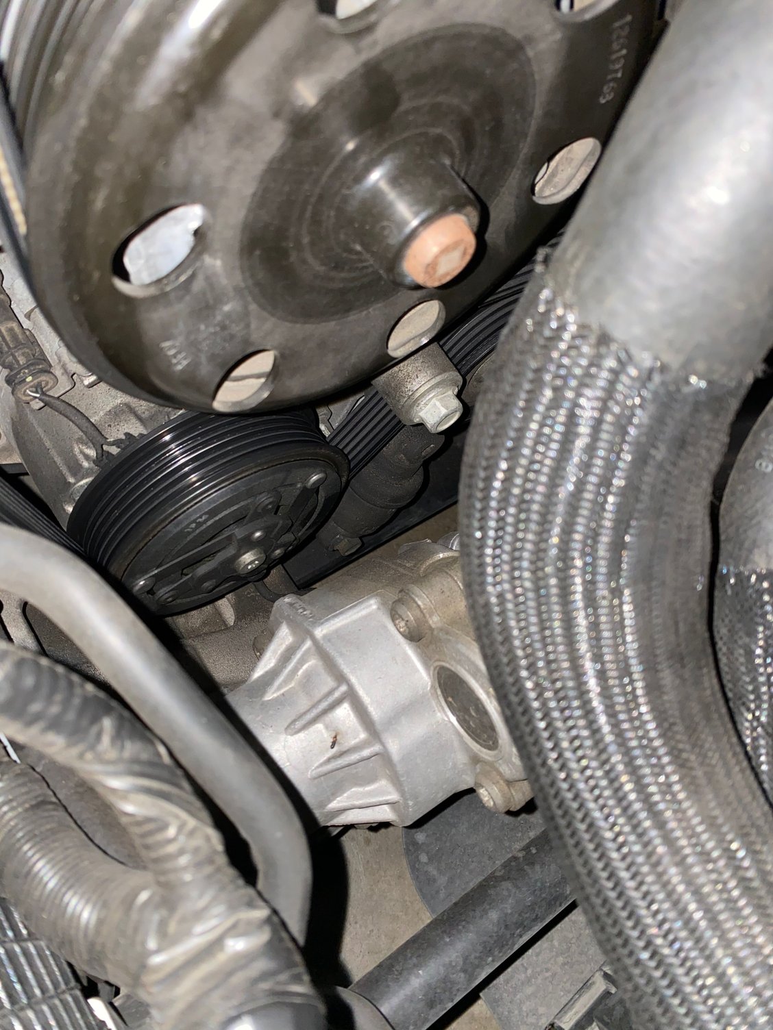

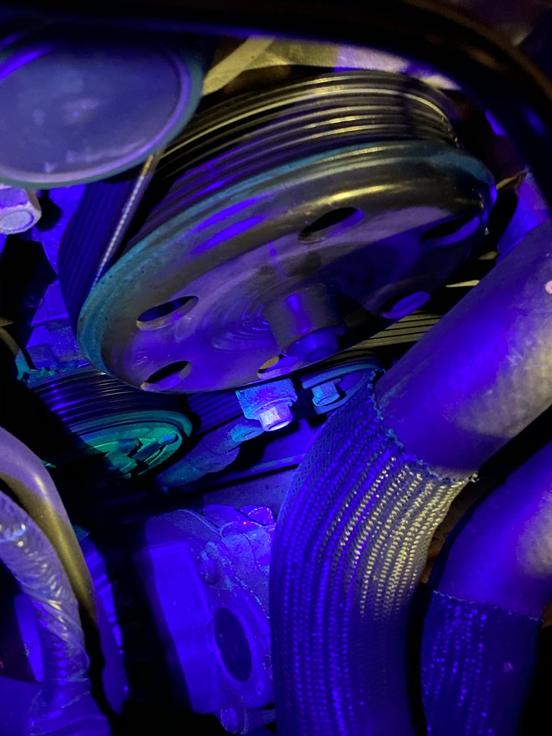

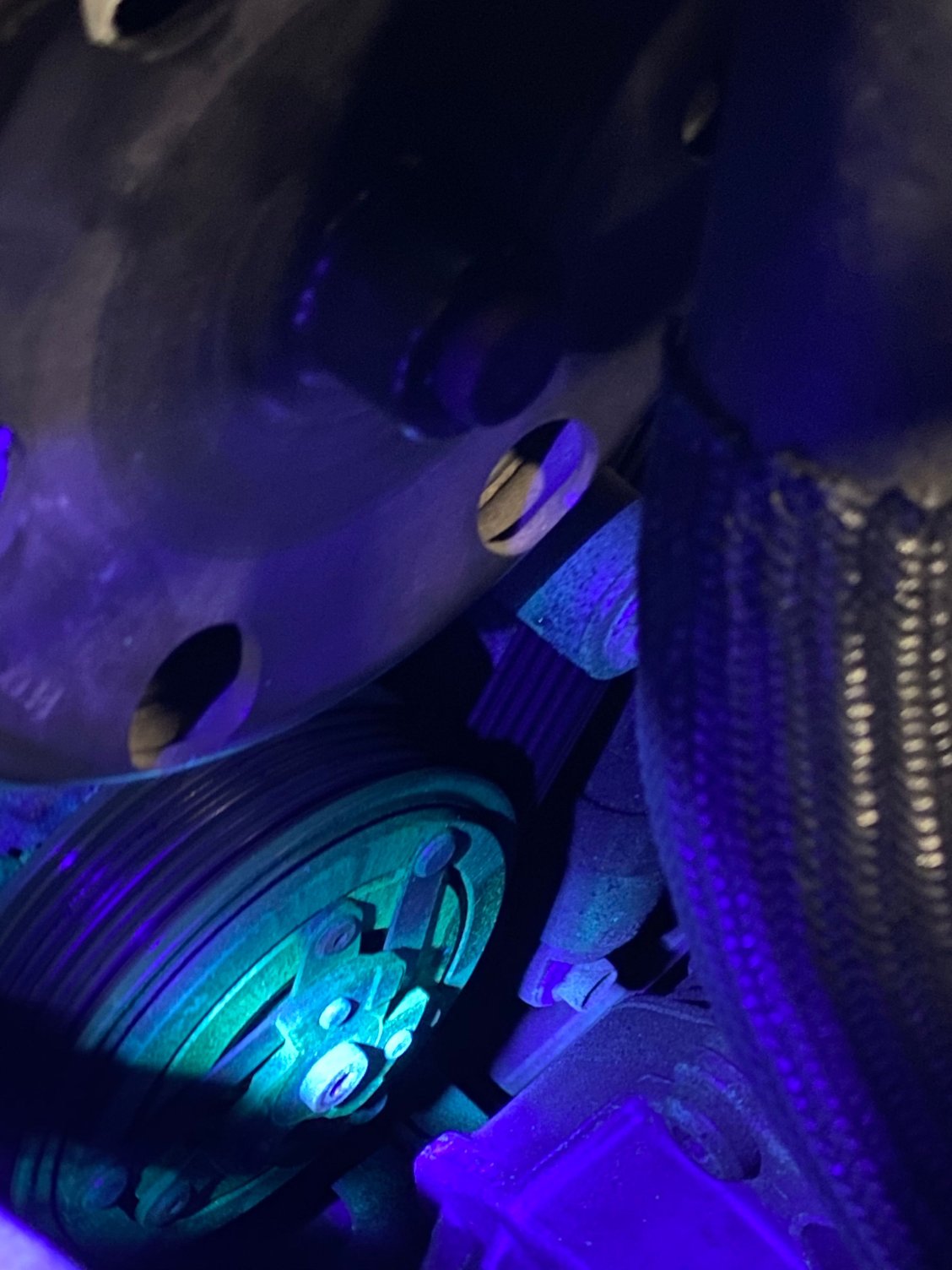

I was recently hunting for a very, very slow engine coolant leak via a blue light with AC Delco dye in the coolant. I can't find squat but I noticed that the clutch on the AC compressor is spewing some oil from the center of the clutch. I'm not an expert but I assume there is a shaft seal in there somewhere. See pics below with and without blue light. There is evidence of it all around the engine bay where it would hit having spewed off the clutch at high speed. The AC is working relatively okay but I bet next Summer I'll be at the dealer for this once the temps get high here in Austin.
It obvious visually that the clutch is a little "oily" by touch but the blue light gives a whole new perspective.
Figured I'd post this for anyone who want to do some DIY on the compressor/leaking.
