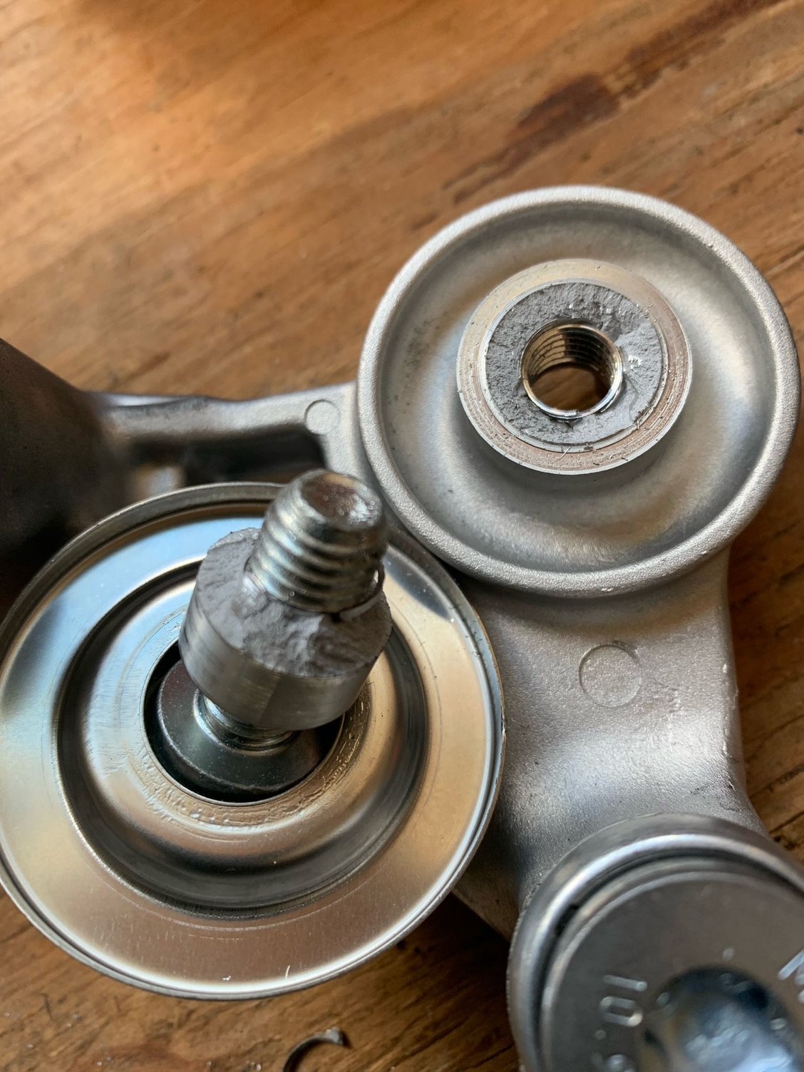

Fun fact: the new GM tensioner assemblies are garbage, as evidenced by the fact that the new one literally broke when I was installing it yesterday ... went to compress the spring to remount the belt and *snap* ... the sleeve that the tensioner pulley bolts into broke. So I just used the original assembly and mounted the new tensioner spring to it, and re-mounted it with no problems. The original pulley was fine, so I still have the new one in case I ever need to replace it.
