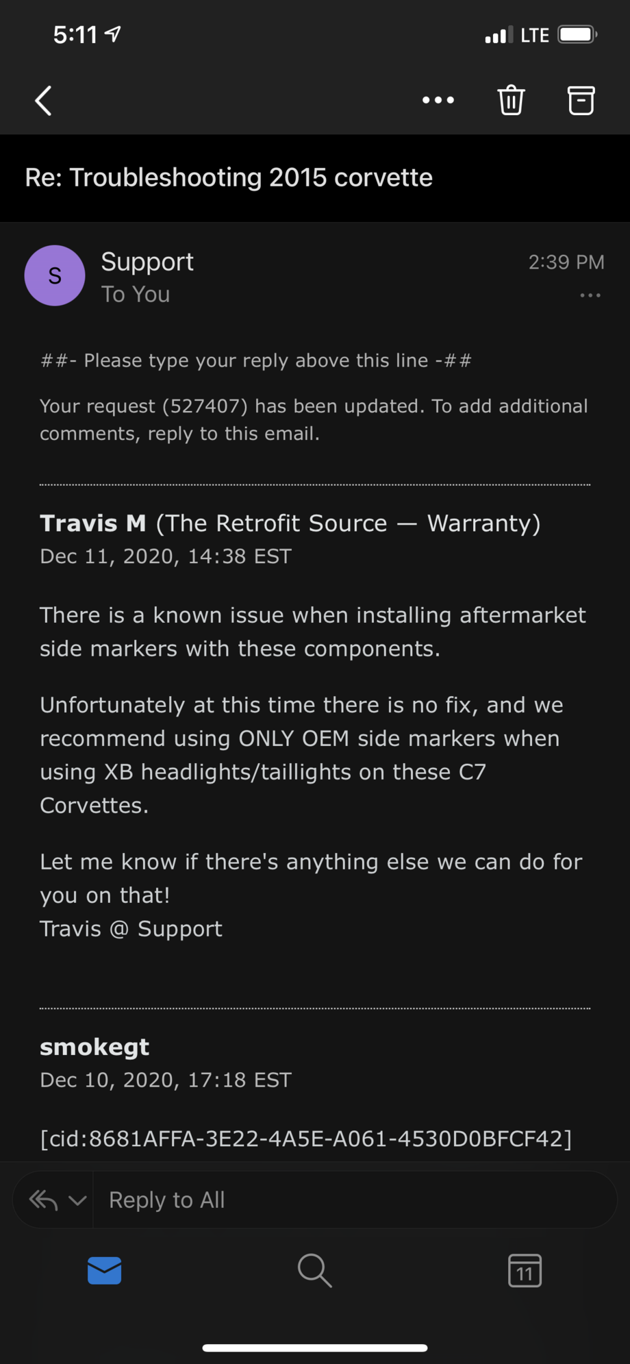

Default Well guess that is a bust
This was what the warranty. Department from morimoto had to say about it. I will include the screen shot.
This is a screen shot of the reply I got from morimoto.
Old Dec 11, 2020 | 06:39 PM
eboggs_jkvl's Avatar
eboggs_jkvl
Moderator emeritus
Joined: Jun 2001
Posts: 18,599
Likes: 3,951
2015 C7 of the Year Finalist
Well, that kinda sucks as an answer.
