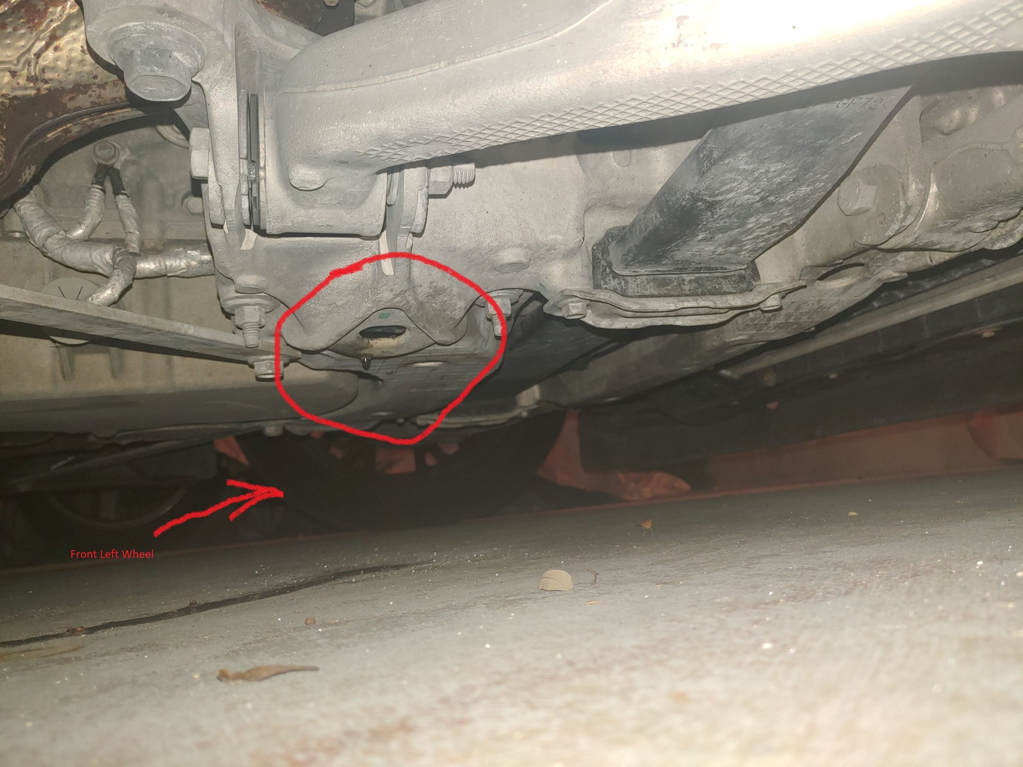

Hey everybody, I have a small coolant drip coming from that hole, I have to add coolant about every 2 weeks or so.. I have checked all the hoses I could find, changed the water pump that had a little play after 50k miles, and for the life of me I cannot find the source of the leak, anyone here have any ideas? It's a C7 2014 A6, Thanks!

Take it to a shop that can do a pressure text on it that may be the only way if you could get it on a lift. But remember the leak will be in front of that drop down of coolant. PS if me I would do this sooner than later due to if things go bad big time you may be out on the side of the road. Are in a place you wouldn't want your car to be for any amount of time. Will cost you nothing if you take it to auto zone are a shop like that.. Robert
