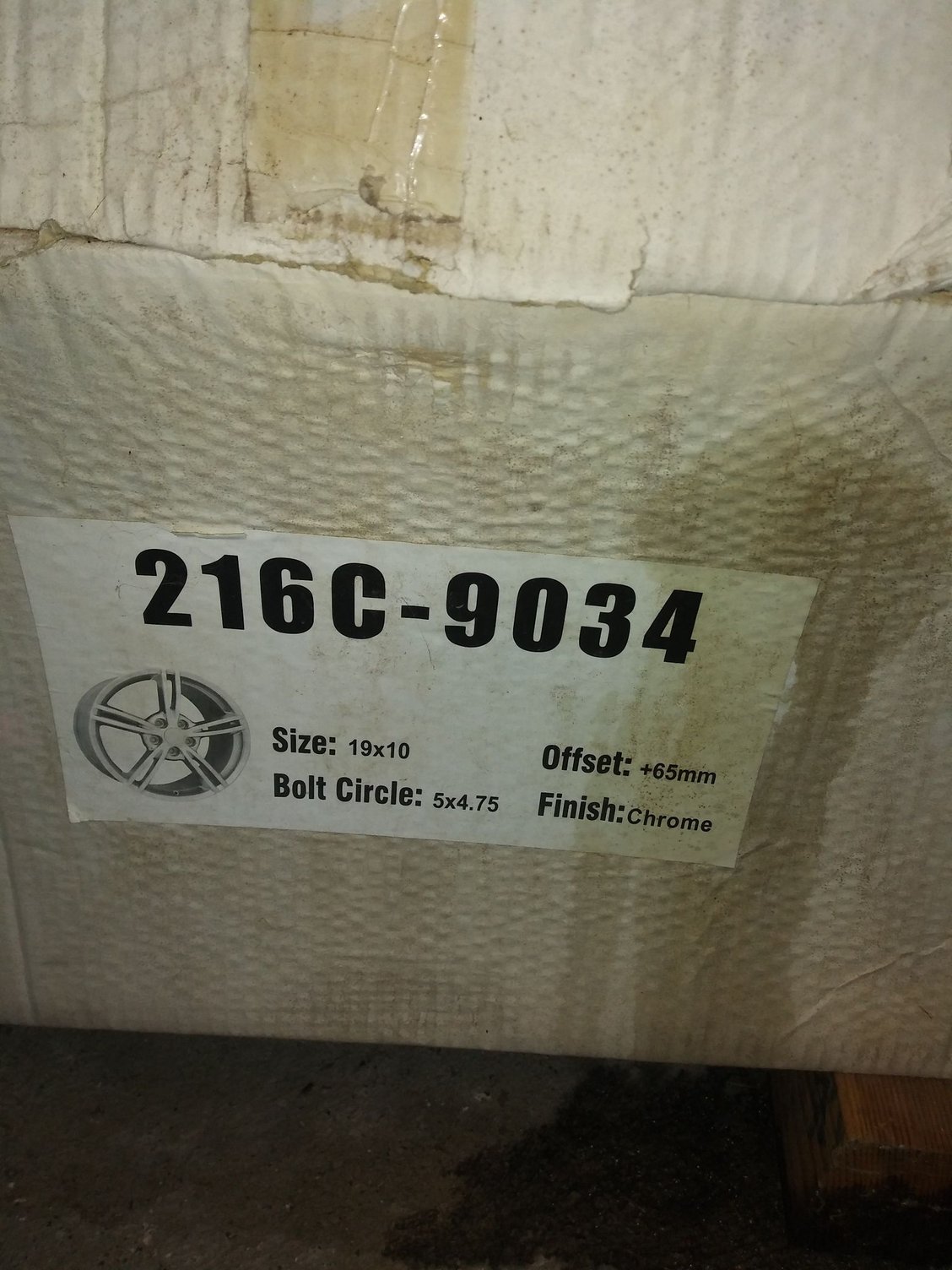

Can anyone tell me if this style wheel in 18/19 sizes will fit my C7 Z51? The off sets are shown.

They did not work on mine although the company I bought mine from off Ebay said they would. I did test fit them but did not put the lug nuts on and torque them. They seemed fine on the test fit but once I mounted the tires and went to install them with the lugs and torque them they wouldn't spin on the hub because they were hitting the calipers. Buy at your own risk.
