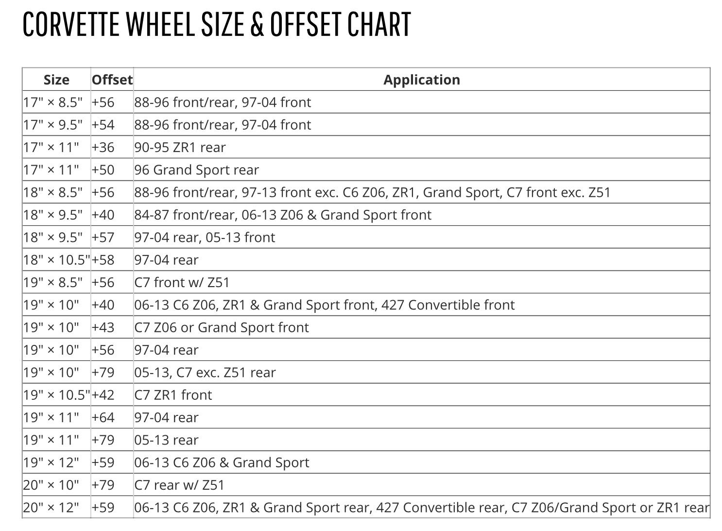

I'm having a heck of a time finding forged or flow formed wheel offsets that are close to stock. Stock is +40 and +59. Spoke w/Forgestar and they are +30 and +51. Apex and Cray are similar.

I believe stock OEM offsets are +43 & +59 for GS & Z06
You are correct. I checked this on two different web sites. The C6 wide body fronts are 40.

Thanks to MMD for the info. I tried Forgestar and was told (by them) that they are unable to go beyond +34 in the front and +50 in the rear. The concern I have is tire
rubbing in hard braking and cornering using stock tire sizes. I don't want to change the wheel sizes (ie drop to 19" in the rear) as it changes the chassis handling dynamics.
I autox a '77 Vette in SCCA CAM class and had fewer headaches completely rebuilding that car (a basket case) to get it ready for tracking. I'll try APEX next. Thanks, Guys.
If you change to 19 or 18 out back but keep the tire diameter the same.. the car won't know the difference.
Also from 34 mm to 43 mm and 50 mm to 59 mm is so small that you won't tell a difference. That's about 3/8" further out. No big deal. I (and many more) run 18x11 and 18x12 wheels with +34 (which adds another 1/2" further out up front) and +50 offsets.
