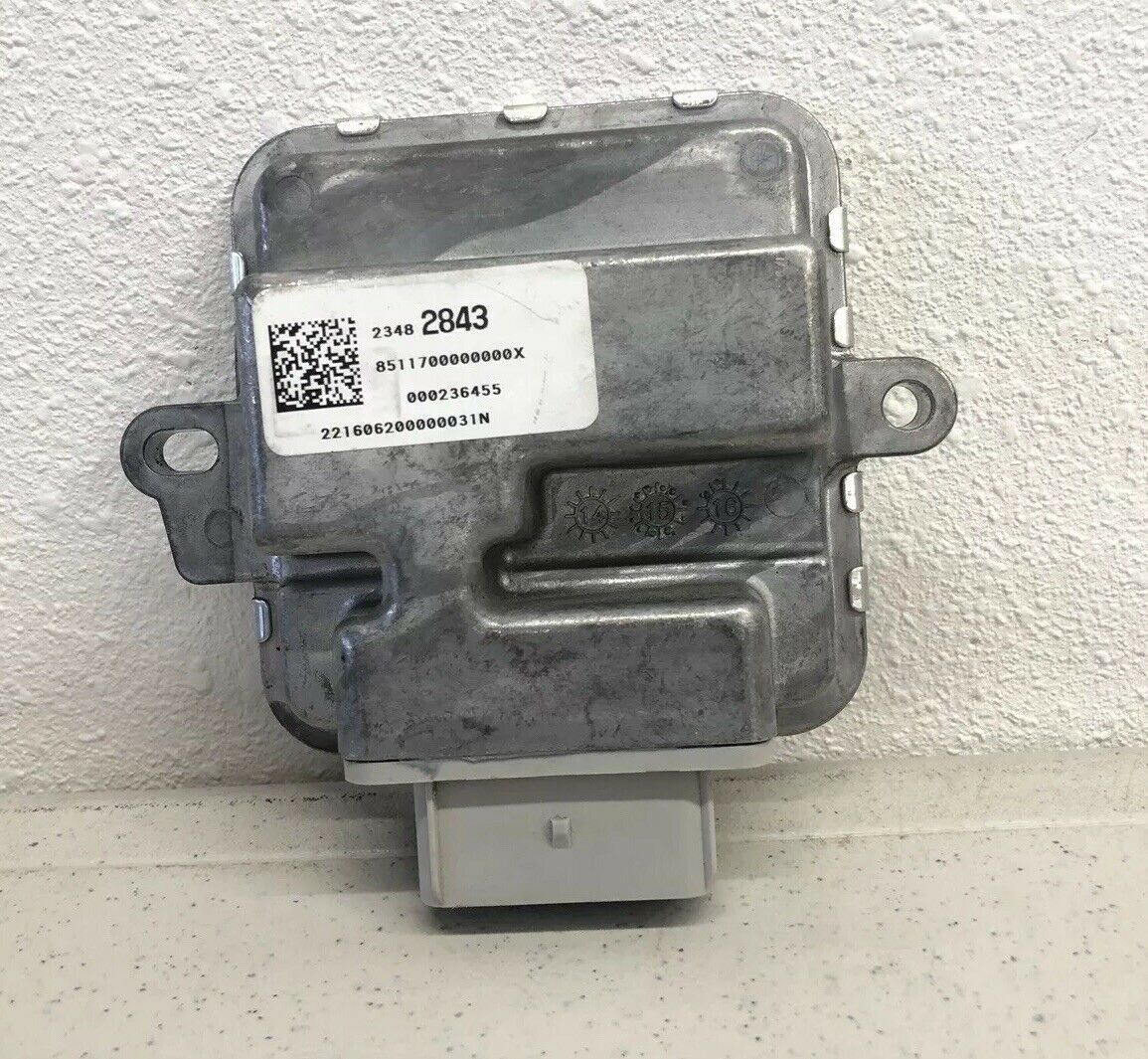

Hey all. Bought a JMS fuel pump booster for my C7 Z06
Before I start taking panels off I don’t need to, any of you know where the fuel pump wiring harness is or module?

The fuel pump driver module is on top of the driver's side fuel tank.

The Fuel Pump "Module" (the pump and the gas gauge float/sensor) is at the top of the fuel tank, which would require dropping the tank to access.
The fuel pump CONTROL module is located in the rear drivers side wheel well, behind the wheel well splash panel/liner. The control module is at the front of the wheel well.
All the wires you need to connect to are located here.

Thanks for the correction. I was just going by the service manual diagram. It looked like it was attached to the top edge of the tank.
