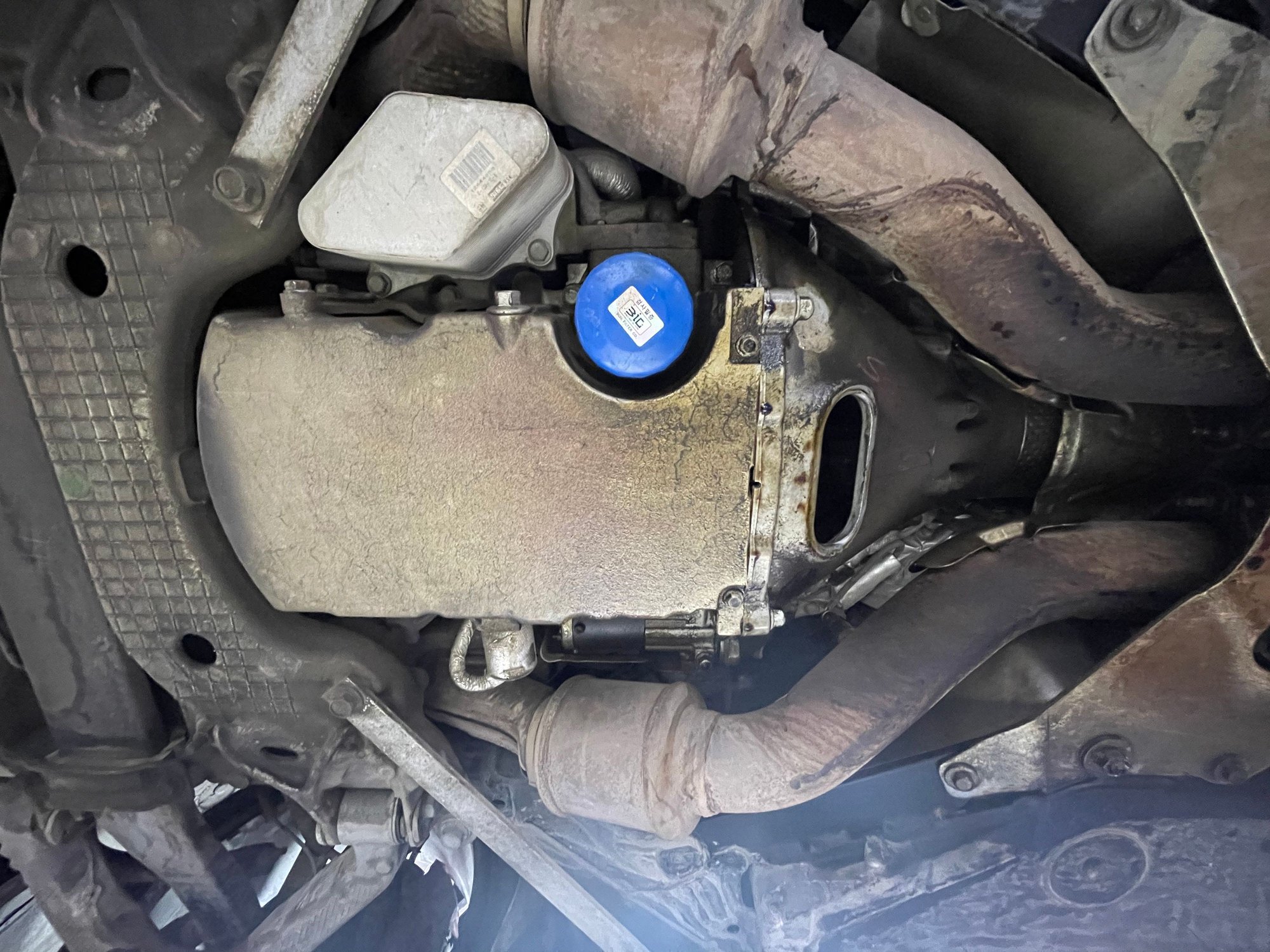

This picture is from the top. Do you have a picture from the bottom so that I can locate the leak? I will send you the pictures of the leak shortly

These are pictures of oil spills, I don't know what to do. I want to know how to do maintenance for them

Looks like source is the oil filter gasket from a previous serious leak. Are you losing any engine oil now? Clean off the oil for future leak diagnosis.

Looks like the filter. The writing on it looks like chinese or japanese. Buy a good oil filter. Wix or Napa from Amazon if they have it.
Wash it real good and get all the oil off, then check it every day untill you spot oil.
My guess is with a good oil filter it will stop.

I agree, it looks pretty dry in the bell housing when you removed the rubber window cover. Good advice to give it a good degreasing wash down to find the source of the leak.

Good advice above.
After you remove the old oil filter, make sure that the gasket has also been removed. Put a drop of oil on the new filter's gasket and tighten.
Gaskets can stick and double gaskets will probably leak.
Ron
