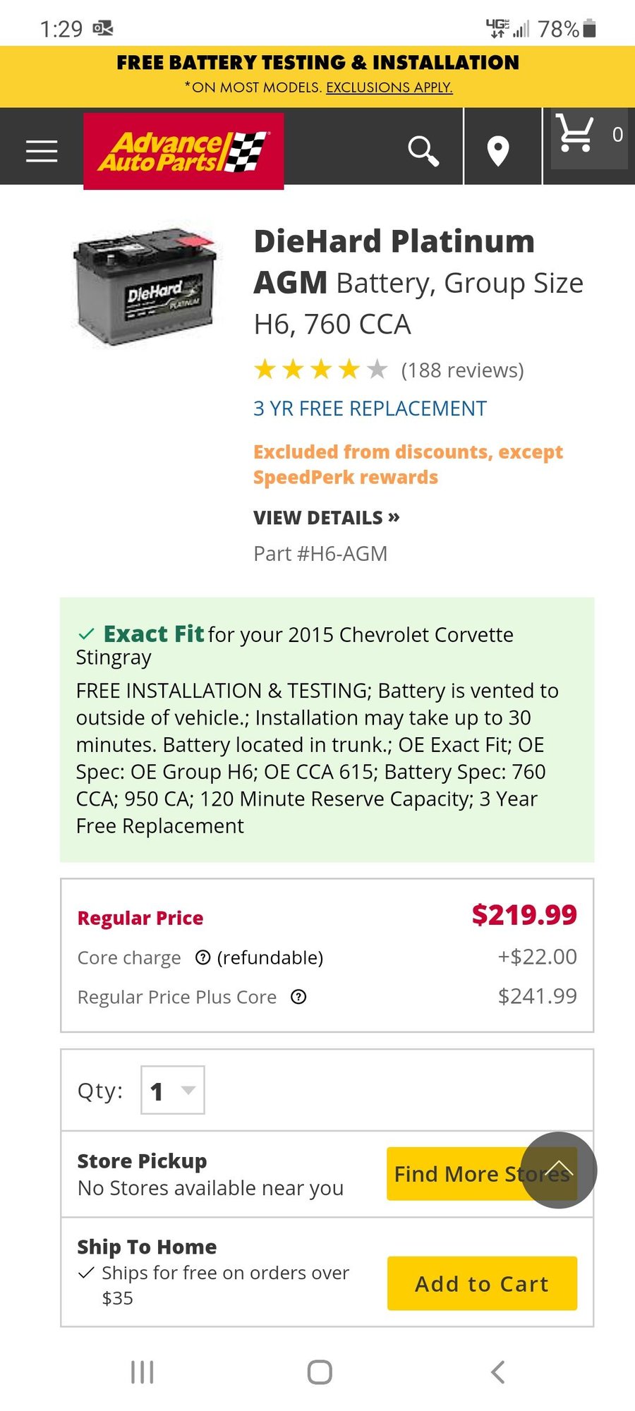

To those who are asking me what battery I installed here is the link
It's the platinum , now they did change the brand to Diehard but it still states that it will fit
https://shop.advanceautoparts.com/p/...ar%20batteries
Dave
