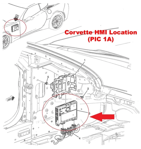

Check the wiring connectors on the bottom of the HMI module located here:
To Radio Problem
