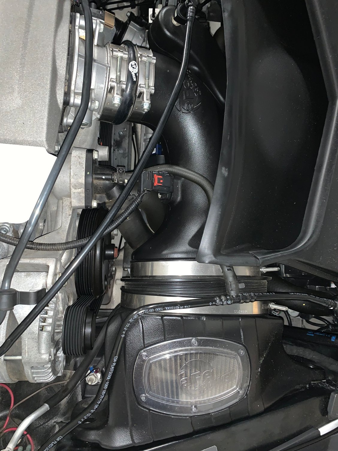

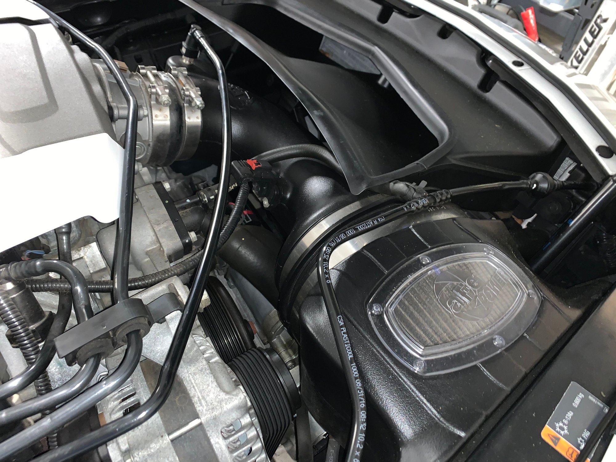

Here is the Intake i purchased and a picture of the problem i am dealing with. Clearly no room whatsoever.

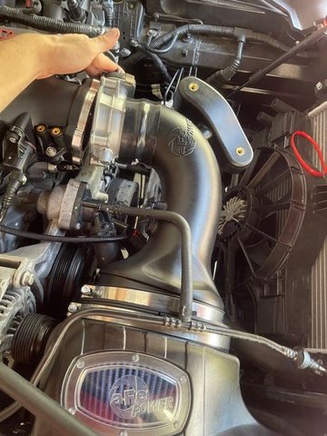

It almost looks like you mounted the boot on the intake section backwards? Here is mine installed.

Originally Posted by dwwalker14335
It almost looks like you mounted the boot on the intake section backwards? Here is mine installed. Looking at this pic, I will need to get you a better angle.
No it is not backwards. It just looks funky because the throttle body is so big and i had to stretch the boot to fit.
Unfortunately this Soler Performance TB does not match the MSD intake Bolt holes, that is why they provide the spacer adapter. I bolted on the OEM TB and i was able to get a proper fit but that just defeats the purpose of my MSD intake .
i am looking to see if i can get a refund on this $600 TB

Interesting. The newer version of the MSD intake manifold looks to be extended and angled to match the OEM setup.
