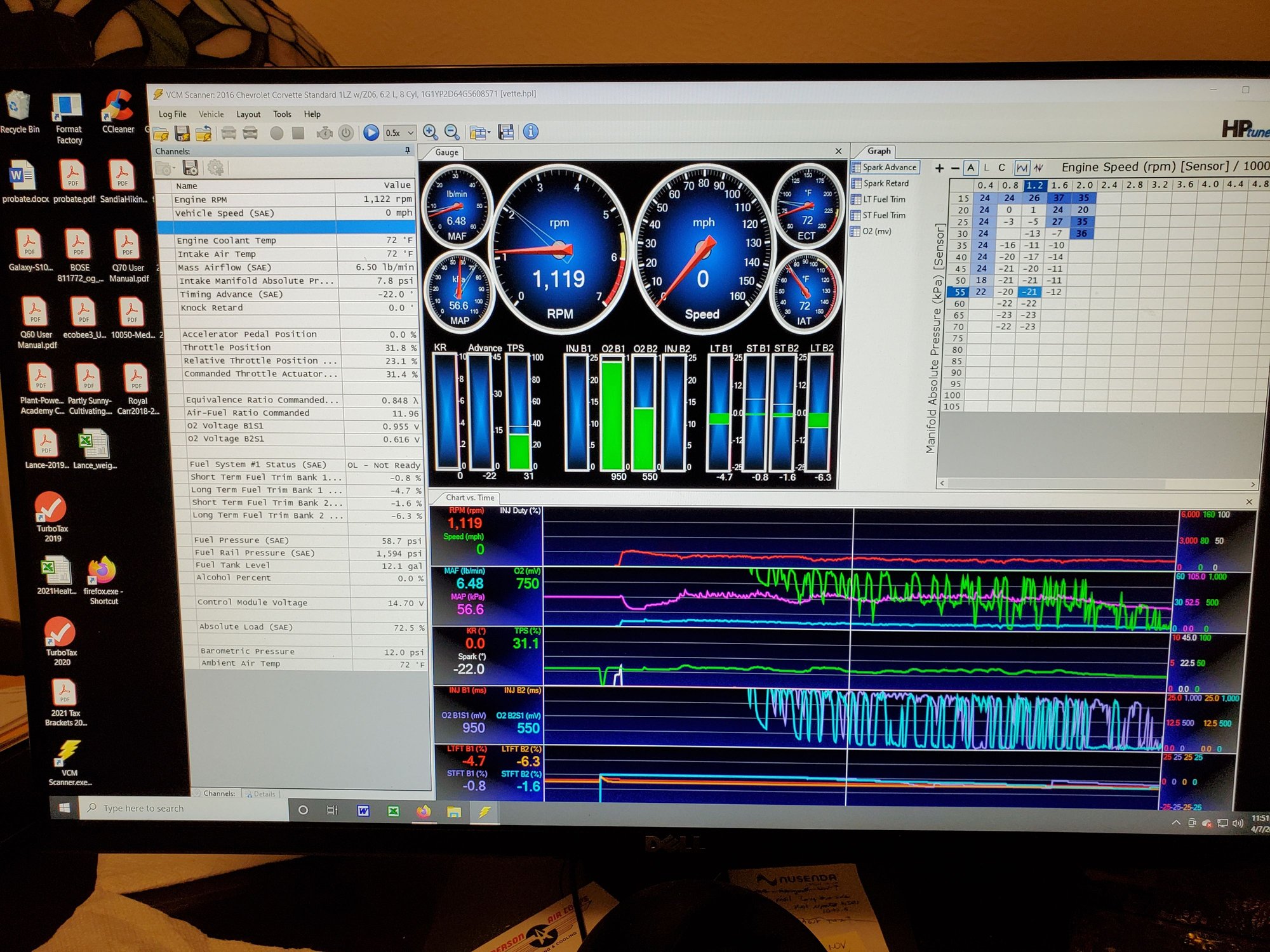

Hey there,
I purchased a V1 Mamo from a friend for my 2016 Z06 (auto) and it worked well for about a week. On cold startup the car runs really rough spitting and popping for about 30 seconds. HPTuners shows it pulling -20 degrees of timing and relatively high kPas (40-70). Is there a sensor in the TB that could be bad? Is There a learning procedure needed? Any help appreciated.

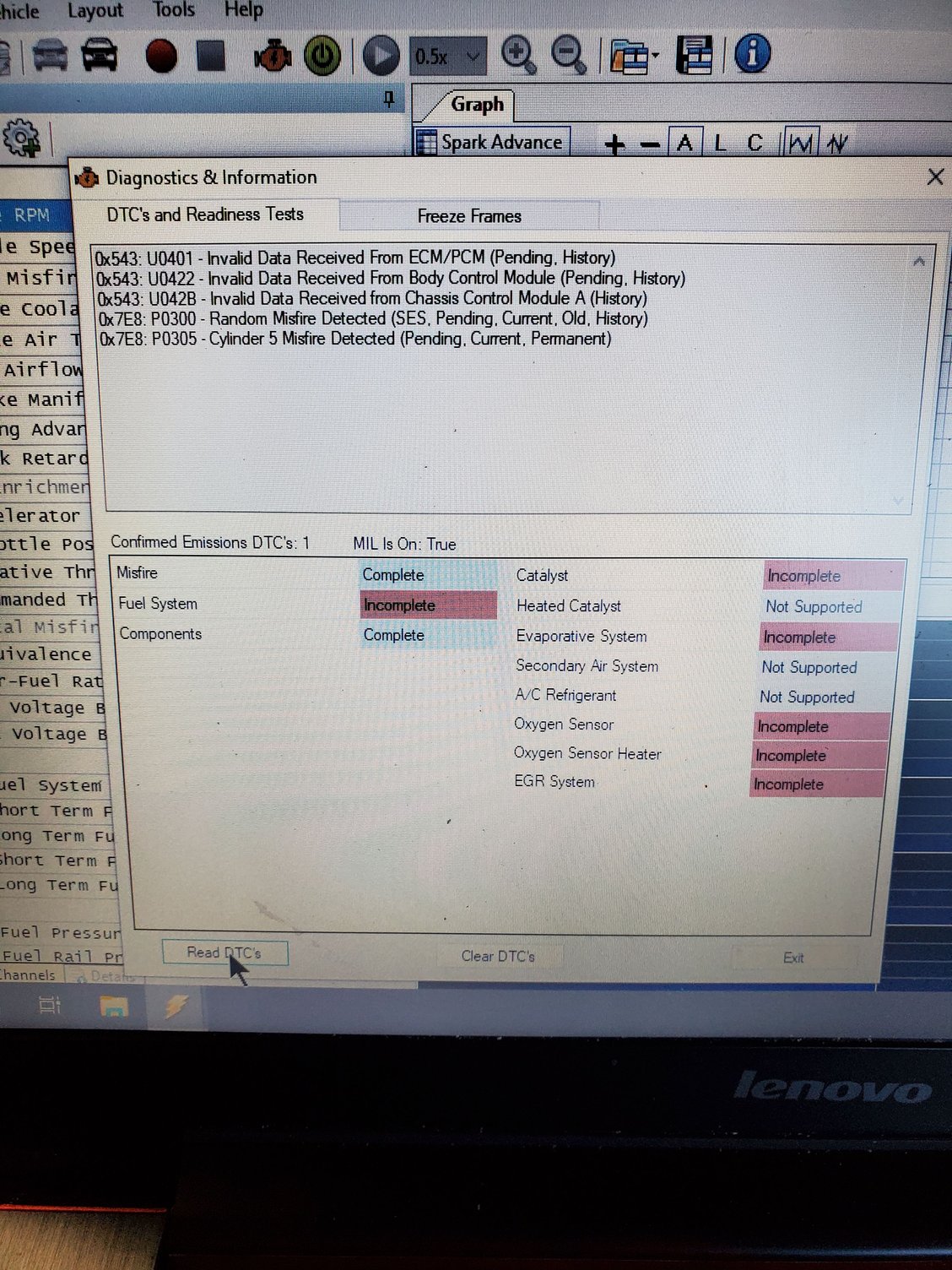

OK. Reinstalled the Mamo and tried the TB learn procedure and got a basket full of codes. Disconnected the battery, reinstalled the OEM TB and let her sit all night. Reconnected the battery, cleared the codes and tried the relearn procedure (run for 3 min, off for 1 minute, run for 3 minutes). Idle was erratic and many codes were thrown.
WTF? Any ideas?

WOW. I don't know. BUT, it looks like after the battery was disconnected the ECM is back to testing the various systems and needs to be driven to complete the emissions testing. Yes?

Sounds like you need to update your HP tuners, I just added an Aem gauge and had issues after that because we added it to the HP tuners log column. Had to do an update on HP Tuners website to get it to read correctly. Once you do that you'll need to resync your Hp Tuners for the new updates.

None of those codes seem related to the Throttle Body. You might have something else going on.

Those are some of the codes I had also, fuel system, etc. I cleared everything, did the HP Tuners update, resynced, reflashed my saved tune and everything was fine. No issues since then and that was just last week.
