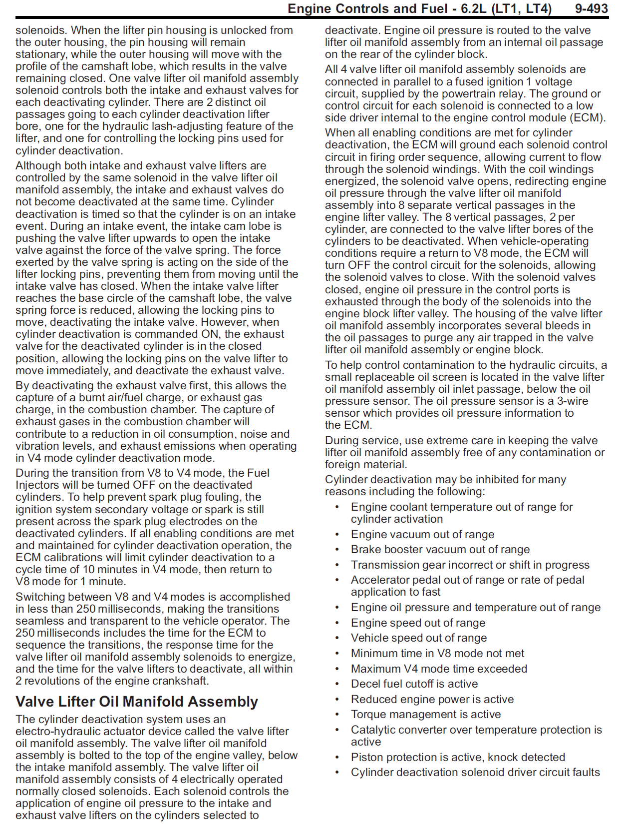

Here is how it works. Right from the Mouth of the General:
Hope this helps.
Bill
