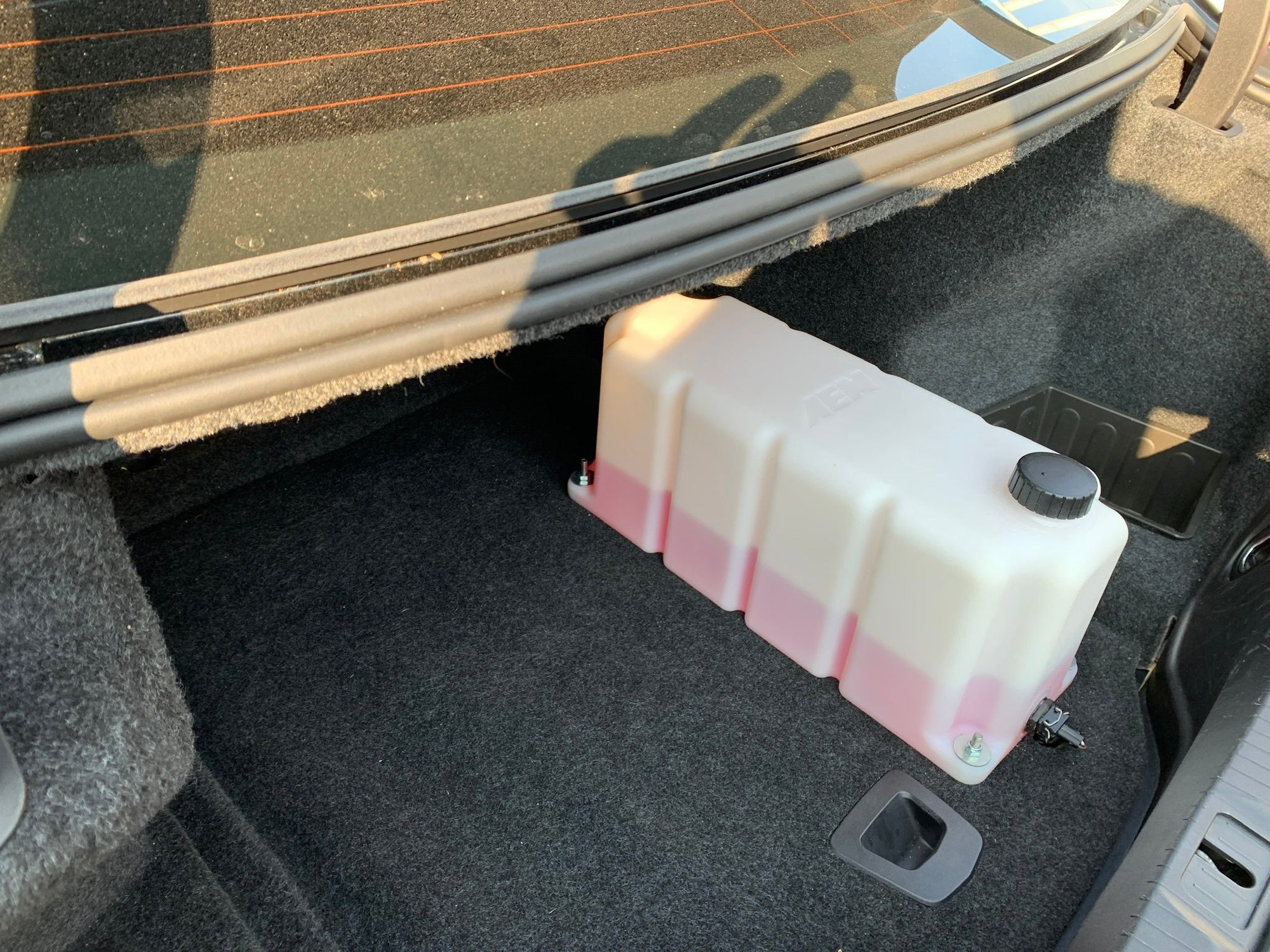

They are going to put a little tank in the trunk area, left rear. Fits in there perfectly and the top still closes so you can't see it. Yes, there is a light showing its low on meth, I'm not really worried about it. I only drive it on the weekend and its not like I'm going in to boost very often.

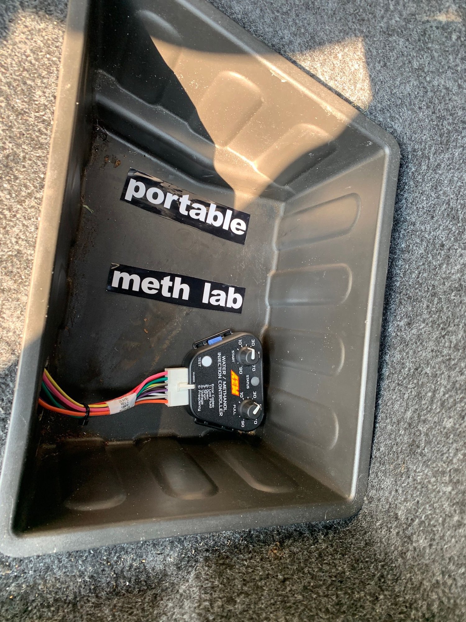

I use methanol injection on my boosted Cadillac and IF I run out of meth the tune has a fail safe built in. Car pulls power and it’s noticeable. I run a 5 gallon tank in the trunk.
