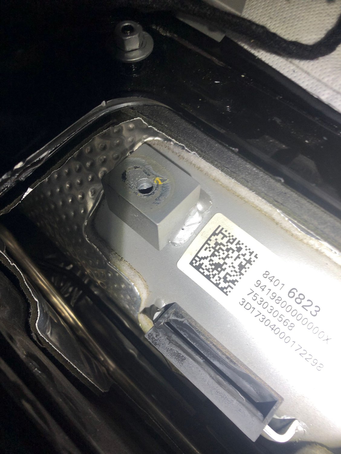

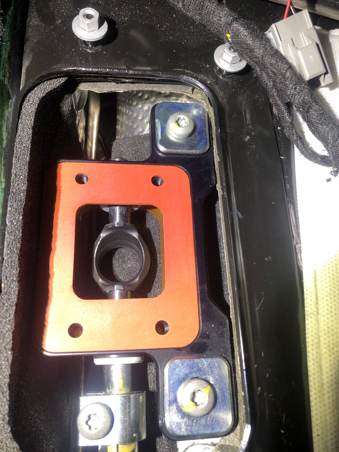

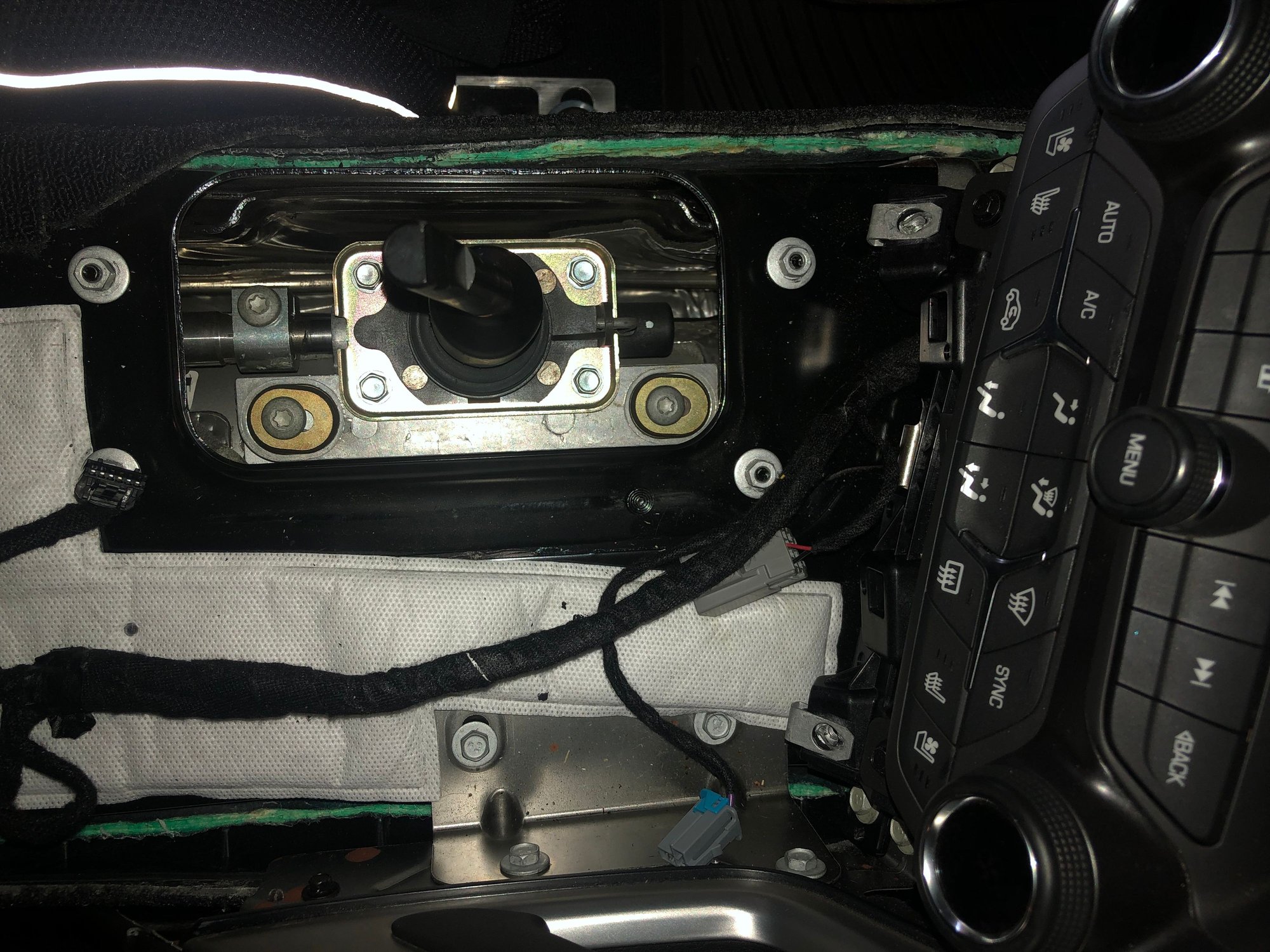

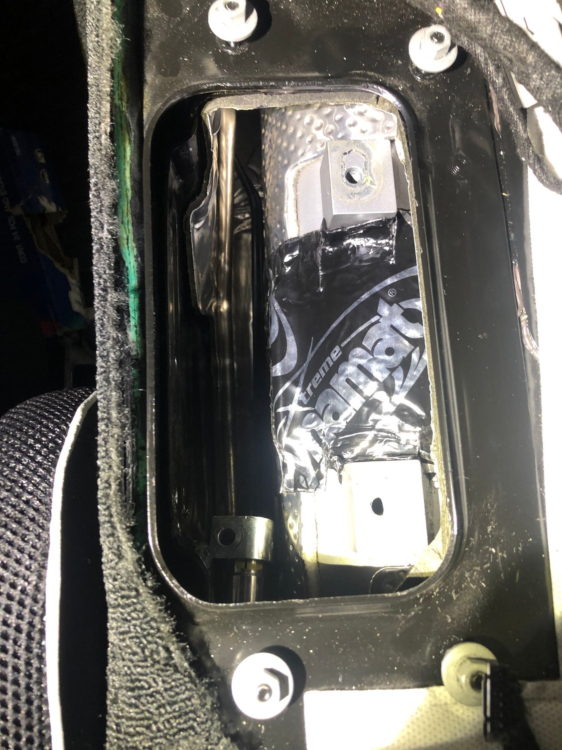

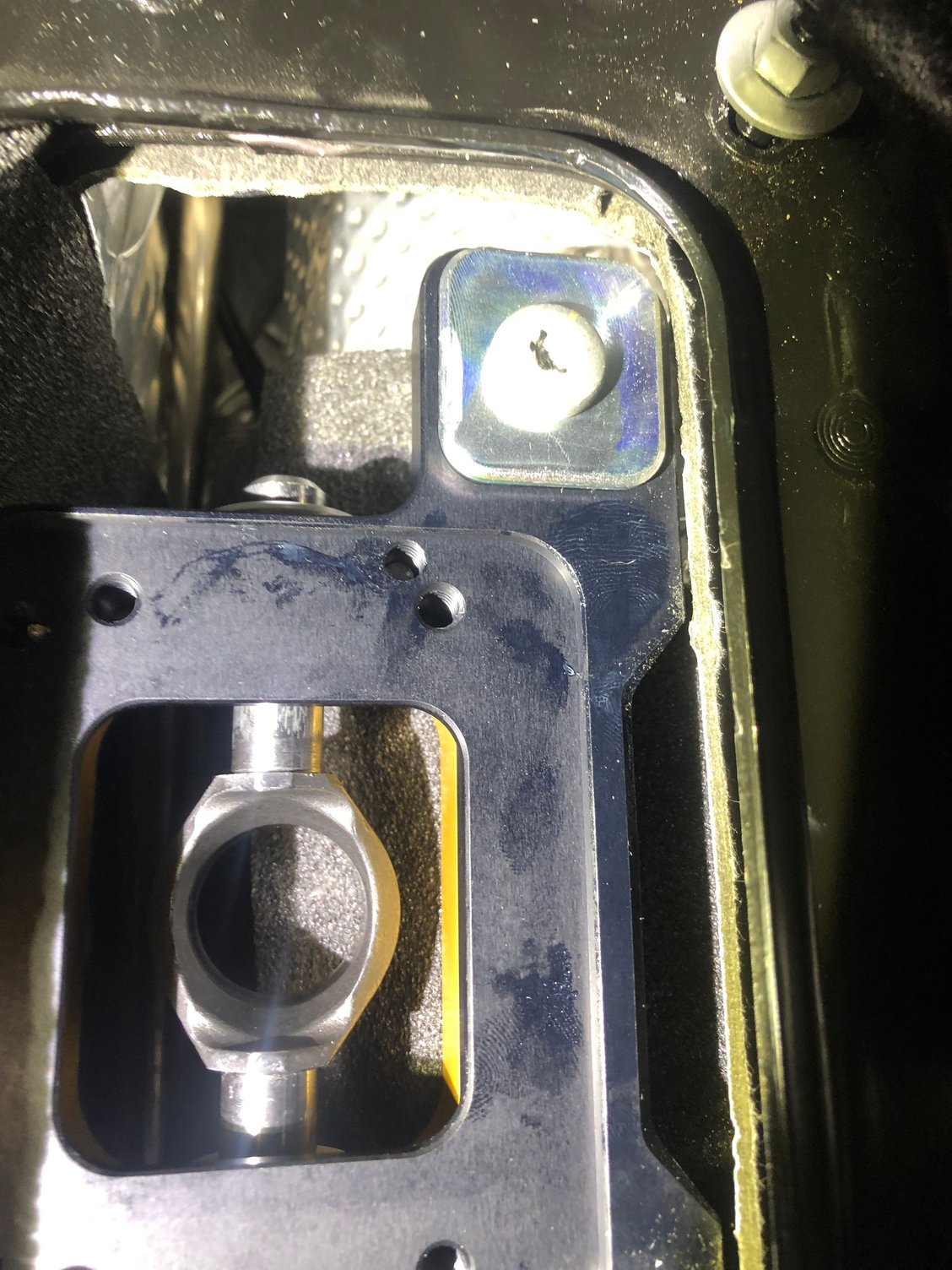

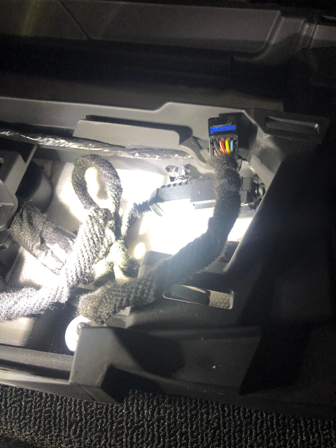

Old Jun 15, 2021 | 04:43 PM
96GS#007's Avatar
96GS#007
Joined: Apr 2000
Posts: 15,344
Likes: 4,009
From: Texas

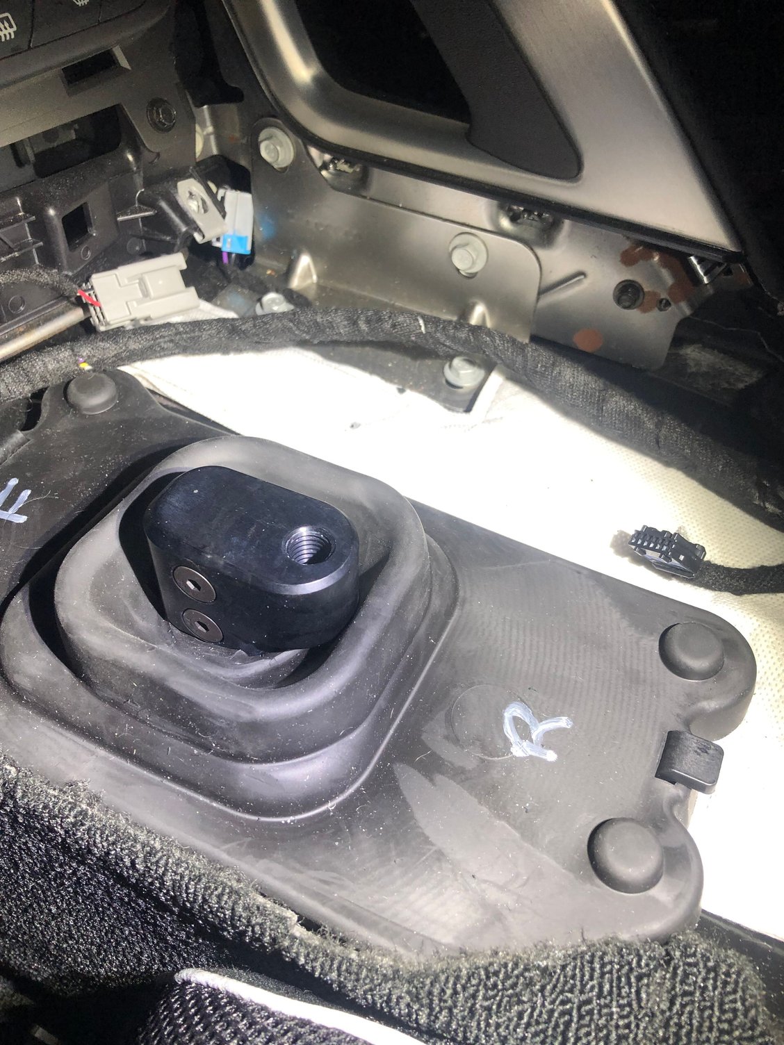

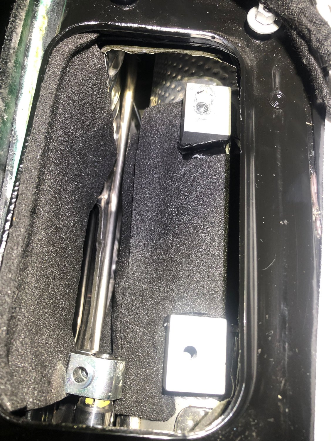

Ditto....2-3 hours going slow and taking pics along the way. A few misc pics are below. One note, if you start the car to verify shifter operation before putting the center console back, you’ll get the Check Engine Light due to the mode selector being unplugged. It’ll clear on its own after a couple restarts and a couple miles of driving.
