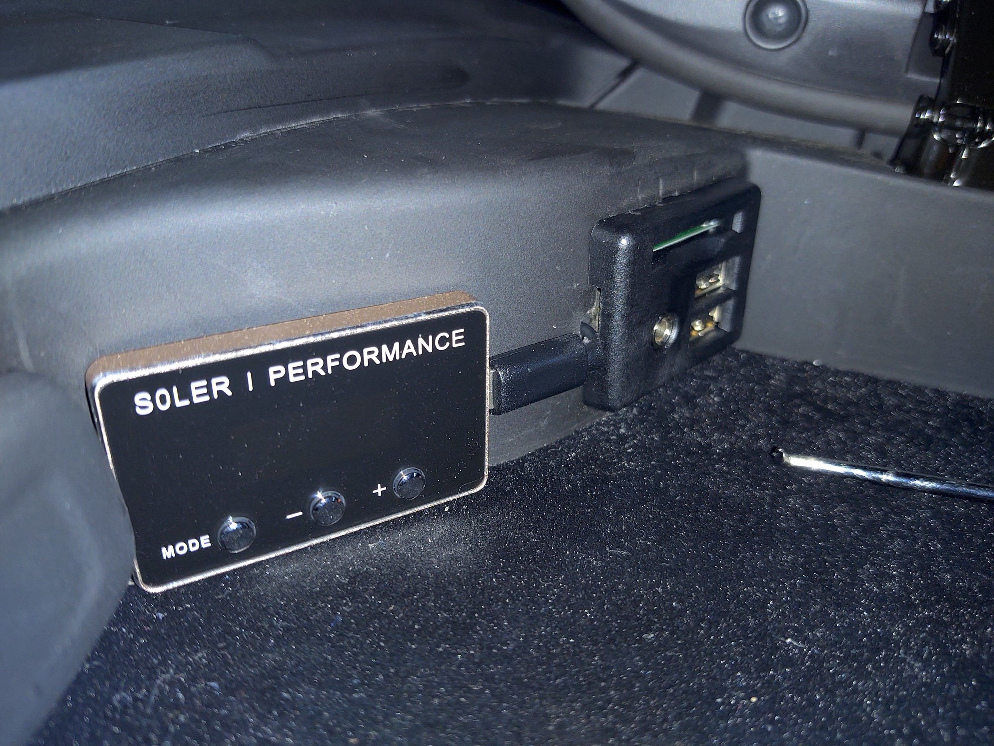

I know there are plenty of posts on this so I will make this brief.
Installed the controller this weekend with the help of my uncle who also has a Z06. Super easy install as others have already said. Finished up tonight by mounting the controller underneath the armrest.
We took it out Saturday and played with it and in my opinion really brought the car to life huge improvement for a very little investment.

@Mike@SolerEngr's service is second-to-none. I also installed mine in the console, but brought it in thru the back, eliminating the need for console removal.

how were u able to run it thru the back??

Wiring was just long enough for this install. I put the controller's "black box" behind/under the carpet. That allowed me to snake the wire you see behind/under the carpet, along the driver's side of the torque tube, all the way to the rear of the console. I removed the snapped-in piece that covers two nuts holding the rear of the console in place, giving me access to loosen the nuts and pass the wire thru the closest hole (next to the nut) and into the console. Hope that makes sense?
