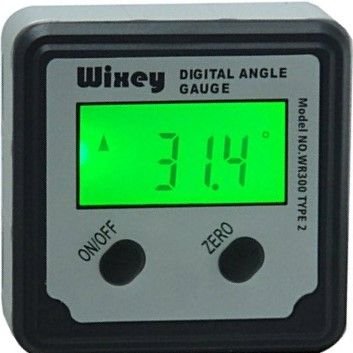

When you adjust rear camber you have to adjust rear caster. And you will need this to do it.
