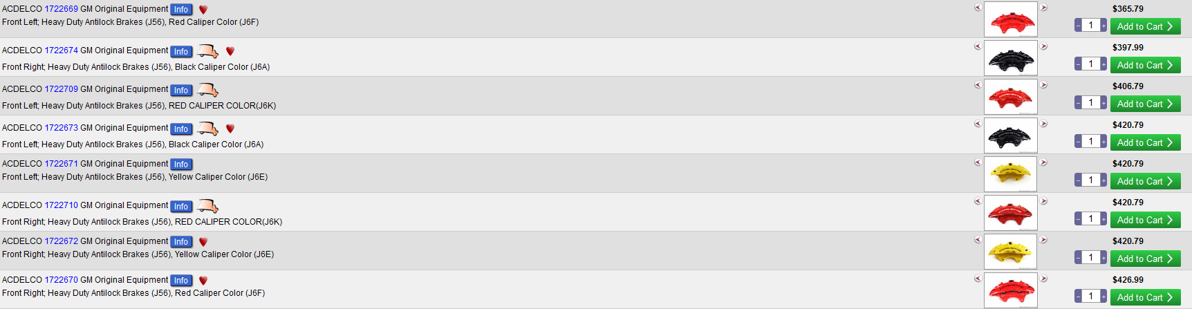

I'm also looking at doing this over the winter (only up front due to already having a Carlisle 15" rear conversion) and was wondering if anyone has actual part numbers for the calipers handy? Or can you verify the AC Delco ones I see on Summit ending in 497 and 498 correct for the iron 2 PC front rotors? And lastly, is there anywhere else you recommend purchasing them? Summit has them at a different price per side for some reason.
Thanks in advance!

Old Nov 2, 2021 | 04:49 PM

Rock Auto has them a fair amount cheaper. Shipping will add to it a bit though. There's still that weird price difference between right and left, and between different colors.
Hey thanks for that, Jeff! I've never ordered from RockAuto before but I have heard a lot of people talk about them. I guess it's time I give them a try! 🍻
