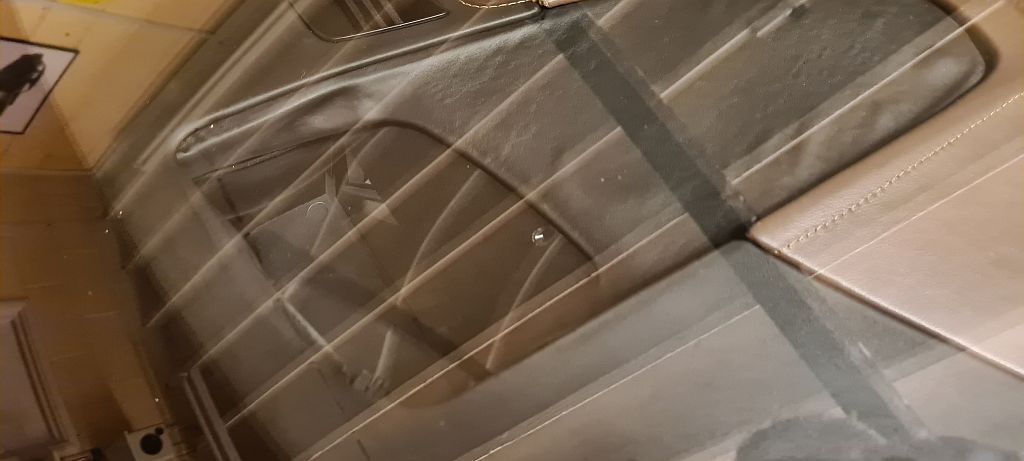

I have seen the "How to" posts on removing the drivers and passenger side dash trim sections on here BUT I need to know if it is possible to go further and remove the whole dash pad for 3LT trim repair?
I don't want to get the windshield removed because I live in the UK so any professional windscreen repair company here wouldn't know where to start with a Corvette let alone source a new one if it gets damaged.
So is there any way of getting it off and out?
I just bought this car and it looks like it has sat in direct sunlight for a while so the leather shrank and lifted.

Do yourself a favor, take it to a certified Corvette tech. You literally have to remove the steering wheel and dismantle the entire dash from the console to the windshield. It is a very complex job for an untrained individual. If you are under warranty, you're in luck. If not, pony up the cash and move on. I've read where the job is roughly $3,000 American. It has been noted that if you have a cooperative dealership that will go to bat for you, sometimes GM will authorize the repair at a reduced cost to you. I read in one instance where an owner only had to pay $900 after negotiating with GM.

The real question I am asking is not HOW to do it. - The question is - "is it possible to do with the windshield in place".
I don't want to strip out the whole dash just to find the glass has to come out anyway. ;-)
Has anyone on here even attempted it or had it done??

I had mine replaced. No need to remove the windshield. Although, if you do, you won't have to gut your interior. If all you intend to do is repair your dash, removing your windshield would be the easiest way to go.

Just to be clear. If you are replacing the dash, removing the windshield is not part of the process. If you are intending to repair the dash in place, removing the windshield is probably the way to go.

I have watched a video on removing the windshield and it does look like it will be the best way.
I can make a thin steel cutting tool to work through the adhesive holding it in.
In the past on older cars I have just used fishing line and/or grass strimmer (weed whacker) line to work around sawing through.
But first I will make sure I can get a replacement screen shipped to me if the worst happens.
Thanks for this discussion. It has helped me make up my mind about the best way to go about this.
