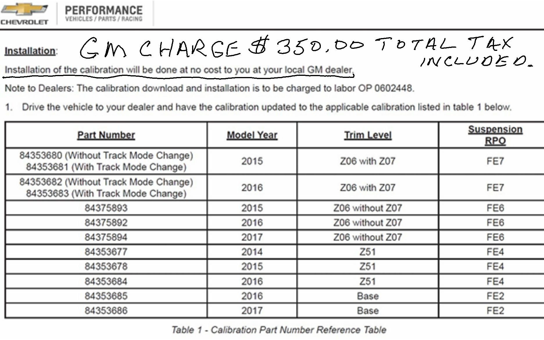

Do you have a car with MRC? If so GM has offered a $350 upgrade to the calibrations for the MRC system which brings it up to the 2018/2019 level. It isn't an update it is an upgrade that is being sold by GM.
Here is the applicable information.
This information isn't included in the normal GM update info since it is a product that is for sale. The mechanic installing the upgrade has to call GM and get a file from them. Service Writers and some mechanics may not know the ins and outs of doing this since it falls outside of their normal procedures. Your best bet may be to start with the Parts Dept. At the time the price for the upgrade was $350.00 Total as it included the payment for the dealer to do the upgrade.
This diagram is 3 years old so the part numbers may have changed. GM loves to roll part numbers so there is a high likelihood they may have changed.
