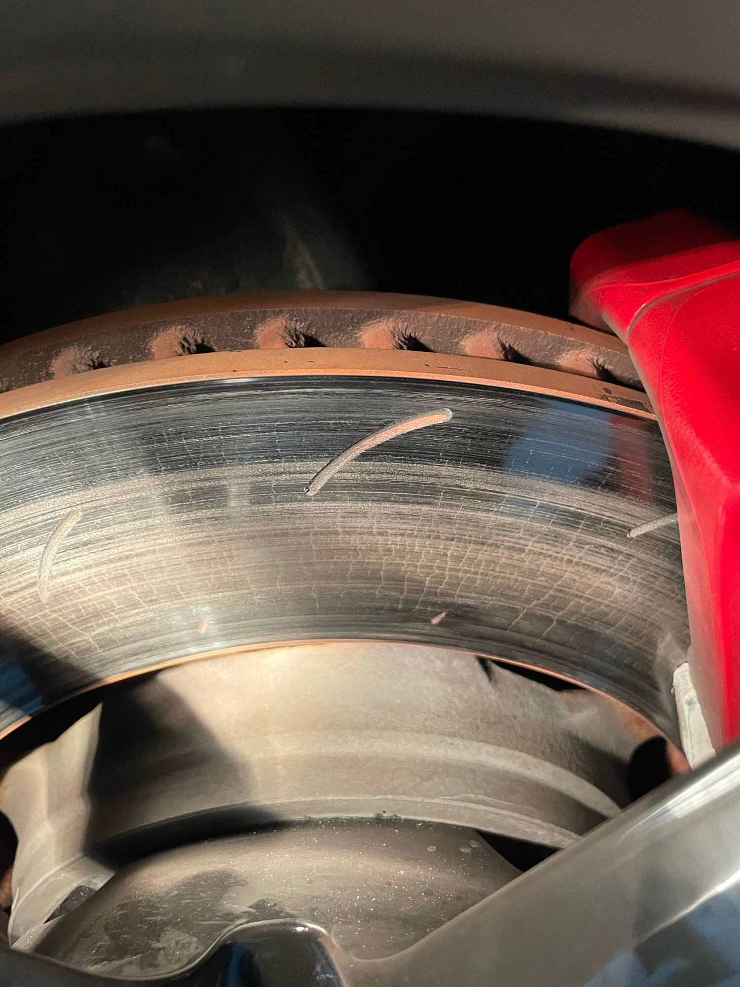

I'm trying to decide whether or not to replace the rotors. All four look like this with the hairline cracks. No cracks larger than the ones in this picture, none are warped, none of the cracks go to the edge of the disc. I run a few HPDE's year. I run Carbotech XP12 on front and XP10 on rear. The rotors are six years old with about 12K miles. Thoughts?

No. They are fine. I replaced mine when the grooves were flush with the rest of the rotor.

Mine look similar from doing occasional track days. As long as your fingernail doesn't catch on those hairline cracks I've been told they are fine. My original Z51 rotors warped long before that, so I run DBA T3 rotors now.
